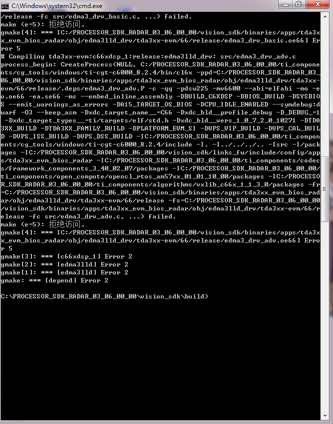

As shown,gmake build failed.What is the reason for this?
did you have any modifications?
Can you try clean build:
gmake -s -j clean
gmake -s -j depend
gmake -s -j
