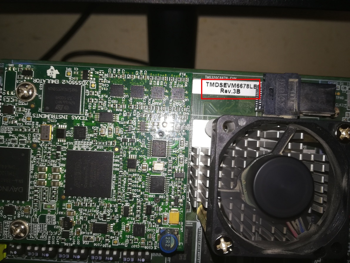

CCS/TMDSEVM6678: Does TMDSEVM6678LE support any probe other than XDS560V2 ?
Part Number: TMDSEVM6678
I have a TMDSEVM6678LE  offering XDS560V2 debug probe via an mezzanine extension card; unfortunately it just broke and not working ....

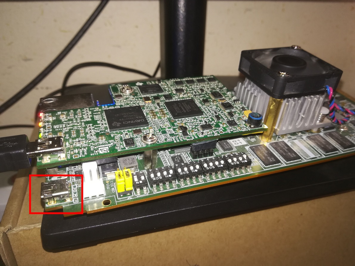

I am wondering if the device has any other probe (eg. XDS100), and if yes how I would be able to get it to work.
I could see another USB port on the main card and I am guessing it is XDS100 but I tried to test connection using three options as you can see below. However, none seems to be working; below I listed test logs for each of XDS100v1, XDS100v2, and XDS100v3. XDS100v2 complains the usb cable may be broken which might be true given it is 1 meter long.
Any advice is much appreciate it.

  • Hello Mike,
    IIRC, the difference between TMDSEVM6678L and TMDSEVM6678LE is that former has onboard XDS100, while the latter has no. Both modules have JTAG header to connect XDS560v2, it's likely your option now.
  • I guessed so too.... but I am curious what is the mini-usb on the main board used for??
    And also is there any workaround to use the Ethernet port for the same purpose ? sorry I come from a software background this may sound a bit silly  ;) the mezzanine card is dead and I am looking for a replacement.
  • Hi again,
    I have missed a little in your explanation. If you're certain mezzanine was dead but processor still okay, I guess you can unscrew and detach mezzanine and use external XDS560 emulator.
    What I see in papers, that USB multiplexes access to either XDS100 emulation, which is absent in LE version, or UART.
    As to Ethernet... I am certain one can boot DSP over Ethernet, but have no idea about debugging...
    Please read through the EVM Technical reference manual:
    The on‐board embedded JTAG emulator is the default connection to the DSP. However
    when an external emulator is connected to EVM, the board circuitry switches automatically
    to give emulation control to the external emulator.
    When the on‐board emulator and external emulator both are connected at the same time,
    the external emulator has priority and the on‐board emulator is disconnected from the DSP.
    The third way of accessing the DSP is through the JTAG port on the AMC edge connector,
    users can connect the DSP through the AMC backplane if they don’t use the XDS100
    on‐board emulator and the 60‐pin header with the external emulator.
    For you, 1) removing the xds560v2 card 2) use xds100v1 on-board emulator.
    Regards, Eric
  • Hello Eric,
    So this is not true that TMDSEVM6678L has XDS100, but TMDSEVM6678LE has no?
  • rrlagic,
    Both TMDSEVM6678L and TMDSEVM6678LE have the onboard XDS100 USB emulation. TMDSEVM6678LE comes with an additional XDS560 mezzanine card for fast emulation access.
    Thank you very much for always supporting us on the forum!
    Regards, Eric
