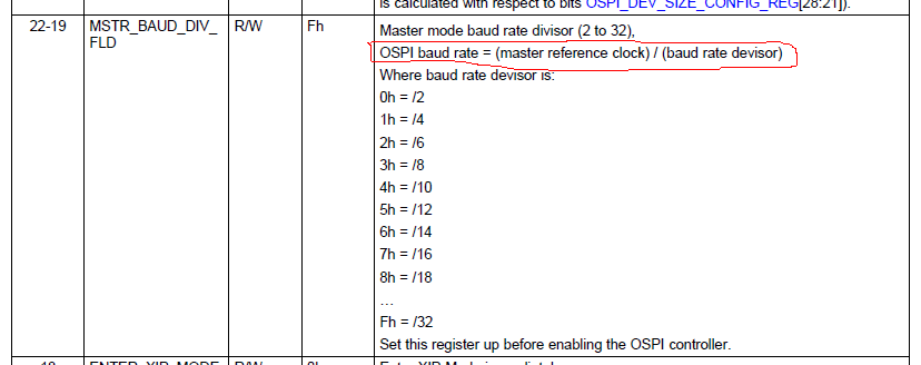

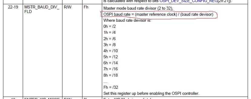

  • Hi, Karan:
         thanks very much for your update.
       1、ROM uses 1S-1S-8S mode to be exact. is DDR or SDR?
       2、The following table shows the baud rate calculation in OSPI_CONFIG_REG register. The "master reference clock" in the table is the "assigned-clock-rates = <133333333>" field in the DTS. Although bits 19-22 are set to 0, the output clock of OSPI is "master reference clock" / 2 = 66. 6M, so if I want the OSPI output clock to be 133m, do I need to change the "assigned-clock-rates" field in DTS to 266M?
    chj

  • Hi Chj,
    This is SDR, "s" denotes the SDR here.
    Can you please refer - https://e2e.ti.com/support/processors/f/791/p/910115/3378252#3378252 and see if this answers your question.
