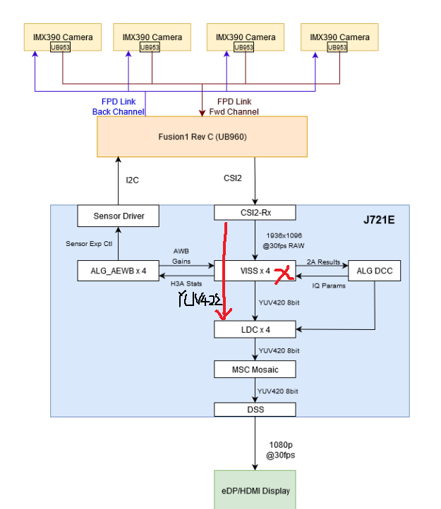

in our coustom board,i test multi cam app follow vision app app_multi_cam.
now:
1.4 cam can capture successfully,i can save 4 cam capture pictures
2.but only one cam display,other 3 cam can not display.
perhaps I need change some code in app_multi_cam.c file,anyone know it,thanks

    Next content is to config sensor,then display one cam
    Multi-Camera application uses mosaic node to merge and to display all 4 channels in side by side fashion, aren't you getting 2x2 mosaic display?
    Rgds,
    Brijesh
  • Hi
    Due to my sensor is yuv format.
    I disable viss,ldc,mosaic node,i only use capture and display node,i can display one cam successfully.
    in this situation,can I change cam to display?only one cam can display(other 3 cam capture picture is ok)
    YUV sensor would require change in the dataflow.
    Because VISS outputs in YUV420 format and then mosaic nodes merges them.
    But in your case, i guess the output format would be YUV422, so this requires to be converted into YUV420 first and then mosaic node can be used..
    Rgds,
    Brijesh
  • how to converted into YUV420?

    The only module, which supports this conversion, is LDC. You need to include LDC node in your data path, after capture node and convert yuv422 to yuv420, then mosaic node can be used to merge channels in 2x2 format.
    Rgds,
    Brijesh
  • Hi
    I read the LDC node code,and include LDC node,i need change the code in LDC node?

    Yes, you need to create output image with the NV12 format for LDC.
    Rgds,
    Brijesh
  • Hi
    First,thank you for you support,now 4 cam can display together 2x2
    But there are new question=》the 2x2 cam display one minutes(short time),the app will dead(stop state)

  • hi
    I think I need show the data flow in my multi cam demo:
    in capture node:
           1.get yuv422 image from sensor directly
    in ldc node:
           1.get yuv422 image from capture node
            2.change yuv422 to yuv420
    in mosaic node
            1.get yuv420 image from ldc node to display
    in my demo,i do not use viss node.
