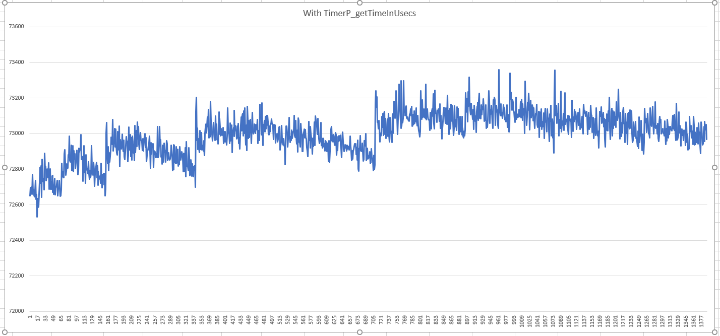

We are using the TimerP_ getTimeInUsecs function several times in our interrupt which is called every 1ms. The interrupt calls TimerP_ getTimeInUsecs, performs a few operations, calls TimerP_ getTimeInUsecs again, then starts the timer again by calling TimerP_start(). We are currently running a test where we measure the number of microseconds before and after 64 calls to this interrupt. When running this test for an hour we see that the number of microseconds it takes for the interrupt to run 64 times continues to increase over time. We have found that by commenting out the calls to the TimerP_getTimeInUsecs function, that the time it takes for 64 interrupts no longer continuously increases. This seems to indicate that the TimerP_getTimeInUsecs function, or functions called by it, take longer to run over time. I realize that by performing operations before the call to TimerP_start() we will not have a consistent/accurate time, however that would not explain a continuously increasing time to complete 64 interrupts, especially when considering that removing calls to TimerP_getTimeInUsecs() resolves the issue.

    void measure_thread( )
        schedule a sem post every 64 calls to interrupt
        while(1)
            pend on semaphore;
            current_time = TimerP_getTimeInUsecs;
            print current_time - previous_time;
            current_time = previous_time;
    void timer_interrupt( )
        start_time = TimerP_getTimeInUsecs; //removing this line resolves the problem
        Do some things
        end_time = TimerP_getTimeInUsecs; //removing this line resolves the problem
        TimerP_start();
    Please see below charts plotting the time in microseconds it takes between measurements from the main thread (64 interrupts). The top chart is with calls to TimerP_getTimeInUsecs in the interrupt, the bottom chart is without. Notice that the top chart the total time continues to increase, while the bottom time value remains relatively the same.

  • I'm not sure that the dmtimer is what we are looking for, that seems to be only a countdown timer. I realize I have made a mistake in my description earlier, it appears that Timer 5 is only set up to call osalArch_TimestampCcntAutoRefresh to handle timer overflows. The TimerP_getTimeInUsecs() function calls down to osalArch_TimestampGet64() which calls osal_TimestampProvider_readCntr() and osal_TimestampProvider_getOverflowCCNT(). It is reading the PMCCNTR cycle count register.
