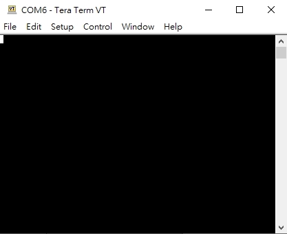

Hello TI expert,
reference information:
PROCESSOR_SDK_VISION_03_07_00_00
VAYU XC5777X EVM BOARD
minicom setting and running results (VA! is present, not AL!):
I got load sbl image and app image into QSPI flash with mflash utility ,as below.
and put the board in qspi boot mode and restart it to boot the sbl and AppImage from flash.
But target board is not work. but sbl is not working. please advising.
user@ubuntu:/home/data1/tda2-eye-detection/ti_components/drivers/pdk_01_10_03_07/packages/ti/boot/sbl_auto/tools/mflash$ sudo ./mflash_run_config.sh
Usage: mflash -M <sbl_mflash> -P <Port Number> -C [optional: to clean the QSPI Flash]-F <fileName> <offset> -F <fileName> <offset> ... [PC] sbl_mflash sbl_mflash_tda2xx-evm
[PC] File 0 AppImage_BE
[PC] Offset 0 0x80000
[PC] File 1 sbl
[PC] Offset 1 0x00
[PC] com /dev/ttyUSB0
[PC] ##########Starting USB/UART Flasing Utility##############
[PC] Put UART Boot Mode, make fresh UART connection & restart
[PC] Press Enter when done...
[PC] Opening serial port successful.

[PC] Time taken to download file = 282.003
[TDAxx] Exiting.
[PC] ##############!!!!mflash shutting down!!!!#############
