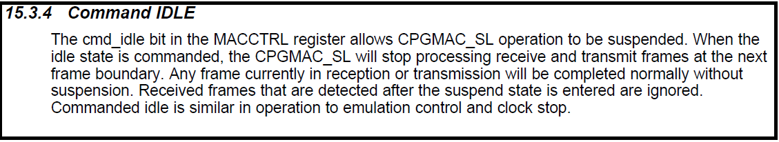

I have question about the command IDLE of CPGMAC_SL.
IDLE state by setting CPSW_SL_MACCTRL.CMD_IDLE I understand that, but how is this to be released?
I cleared CPSW_SL_MACCTRL.CMD_IDLE using CCS(JTAG), but CPSW_SL_MACSTS.IDLE bit was unchanged.
What else do I need to do to recover from the IDLE state?

  • Are the module clocks running?
  • If the port has never gotten to the link up state, it is possible that the ALE.ALE_PortCtl.PortState is still in the disabled state.
    Normally the driver will wait for a link to be reported via MDIO operations and then setup the CPSW.MAcControl followed by ALE.ALE_PortCtl.Portstate to one of the active state depending on if there is spanning tree SW running or not..

  • Unless the gmii_en is set, the MAC has not be started, so the idle function does not apply!
    For the RMII to be retuned back to functional mode, the GMII_EN must be set back to a '1'.

  • CPSW_SL_MACSTS.IDLE is an indicator that the MAC is idle currently not transmitting or receiving.
    It is unrelated to the link status.
