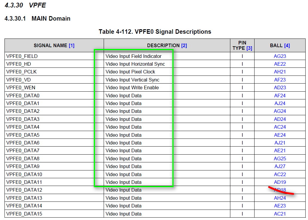

TDA4VM: Does TDA4 have VIN port to connect to DS90UB914?
Part Number: TDA4VM
VIN port(Parallel Video Input) is used to connect to DS90UB914.
The two CSI in TDA4 can connect to two DS90UB960, but the 4 FPDLINK III cameras connected to the one DS90UB960 must be the same, right?
I want to connect one more FPD Link III Camera with another kind of sensor to the TDA4.
