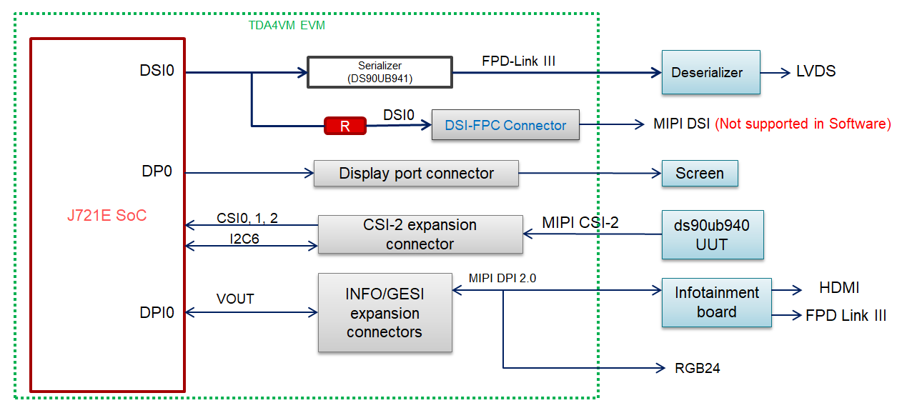

    I have some TI products to be tested (Serializer/Deserializer), I want to generate video patterns from the EVM and send it to product, they will be connected to each other via EVM interfaces.

    On what EVM interfaces do you want to send out this test data - ethernet, PCIe, CSI or some other? Please elaborate further, if you need to use a block diagram to describe your request clearly kindly use visual aids to represent your final intention.

    The interface depends on the product input, it can be MIPI-CSI, DSI, HDMI (via Infotainment board) or Expansion Connectors on the bottom of the evm (it supports RGB24 format).
    Here is a block diagram of the interfaces I want to use:
    Thank you,
    Brahim

    As discussed, you can use the gst-launch-1.0 with the videtestsrc to generate the test pattern.
    Please update the ticket with the command that worked for you so on your end.
    Karthik
