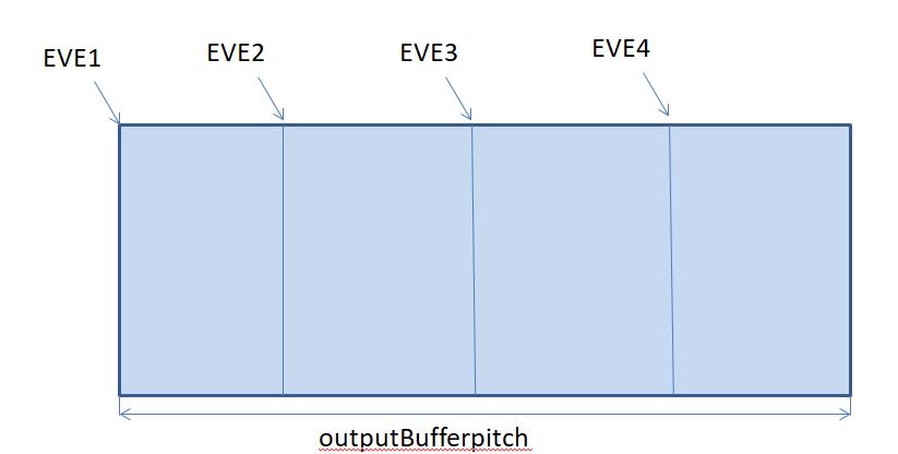

We are using PkDetect Alg plugn to process 16 RX channels output from 4 EVEs running 2D FFT. We create a usecase where we output of 4 FFTs running on 4 EVEs are merged and sync together to form input of PkDetect Alg running on EVE1. The output of PkDetect Alg doesn't look correct however. We are looking for some pointers on how to setup the PkDetect input parameters to let EVE1 knows of the 16RX channels we need it to process. Code snippet below are what we are not sure about.

  • Hi Khai,
        Before programming peak detection applet. Have you configured the output of doppler FFT to have a bigger pitch so that all four EVE's data comes in a single buffer which is what will be fed to peak detection applet?

  • Hi Khai,
        You can control the pitch of the output buffer of Doppler FFt by setting the following parameter.
    bufDesc[FFT_TI_BUFDESC_OUT_BUFFER]->bufPlanes[0].width : This field indicates the pitch in bytes of the output buffer. This field is
    used only when FFT direction is FFT_TI_DIRECTION_VERTICAL. if the value for this is set to zero then the pitch will be calculated internally. For this case size of this buffer should be same as size of input buffer.
    If user wants to control the pitch of output buffer then user should first call the Control call to figure out the minimum pitch required and user is expected to give pitch which is greater or equal to the minimum pitch. The maximum supported pitch is 32767.
        Can you confirm if you are programming the above pitch to account for all the 4 EVE's output
    Anshu

  • Hi Khai,
        After speaking to the team internally it turns out that current implementation is not the way i thought. So in current cascade radar usecase each EVE is independently writing the output to a different buffer and this output is then processed in DSP.
        But the approach which i suggested is still applicable. You can provide a bigger pitch for the output of doppler FFT. You can refer the following file :
    C:\PROCESSOR_SDK_VISION_03_08_00_00\vision_sdk\apps\src\rtos\radar\src\alg_plugins\alg_fxns\radarfft2\radarFft2.c
      Search for outputBufferpitch to find the place where this pitch is set.
    Anshu

  • Hi Khai,
        There is no magic here :). I am assuming that you will provide output pointers to each EVE correctly. This is how I am visualizing this :
      Here each EVE writes output with a pitch of outputBufferPitch but it will only write 4Rx of data and the pointer to each EVE is at an offset of 4 RX. This will make sure eventually you will get all 16 Rx in a single buffer. Hope this clarifies :

  • Hi Anshu,
    One question. Since radarProcessLink_algPlugin.c performs buffer allocation for FFT output and it will allocate the largest buffer size if 4 profiles presents. With each EVE output points to the beginning of each respective buffer, there will be holes for the smaller cube size profiles in the output buffer presenting to PkDetect. Would PkDetect be able to figure this out? Or the 16 RX FFT output data really have to be back to back?
    --Khai
  • Hi Khai,
         16 Rx data is expected to be back to back, and you can control it by appropriately giving the pointer for each EVE and a bigger pitch corresponding to 16 Rx.
