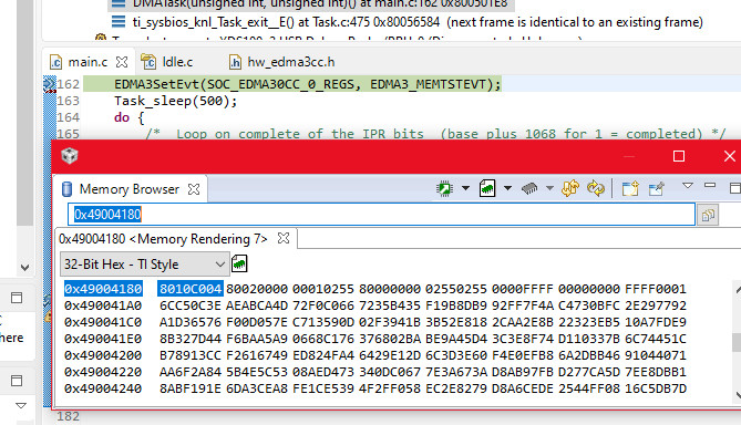

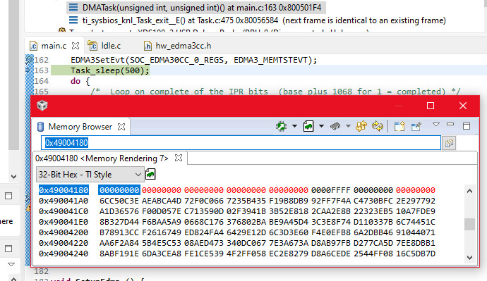

    Doing some debugging, I captured the PaRAM set for #12, and show in memory here  (address 0x4900 4180)
    I execute a single step triggering the event, and, as expected, the param set is now cleared.
    (except for the link, as one would expect)
    Next, it hits the interrupt breakpoint only once.  But the destination buffer is still not been updated.  Leaving the interrupt, and breaking on the mainline loop, the destination buffer is still not updated.
    So now it is to the stage where it completes, and makes me believe the transfer has succeeded, but nothing has happened.  The interrupts for the errors never get triggered either, so there is no indication that there is any problem.

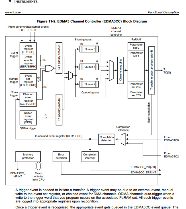

    I am attempting an "A" transfer with ACNT = 0x10 and BCNT = 0x10.  There should occur 16 "events" and it does (there are 16 interrupts that happen)
    From the diagram in chapter 11, repeated below...  I set a manual trigger event.  It should:
    1. Go through the priority encoder (apparently it does)
    2. Go through queue 2  (registers say it's not, but the PaRAM is updated, so it must be... see later screen capture)
    3. Update the PaRAM (it does, see later screen capture)
    4. Notify the TC (I think it's TC2?  the registers for TC2 appear to have these counts and addresses in them)
    5. The TC2 then triggers an interrupt that it's done (It does)
    Wash, rinse, repeat,... the code captures the interrupt, and triggers the next transfer.  All this happens, but the destination memory is still not updated.
    How can the interrupt be triggered by the TC2 if the memory transfer didn't happen??

    Here is the diagram from the doc.

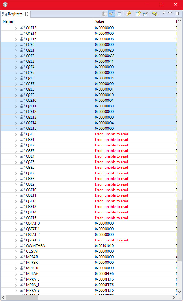

    Here is a shot of the registers.  The entries for Q2Ex all appear to have random stuff.  There is no queue containing the channel/event for the one I am using (event 12 or 0x0c).
    And the QSTAT_2 register STRPTR value never changes.  So, somehow the PaRAM is being updated while this event never gets through the queue...

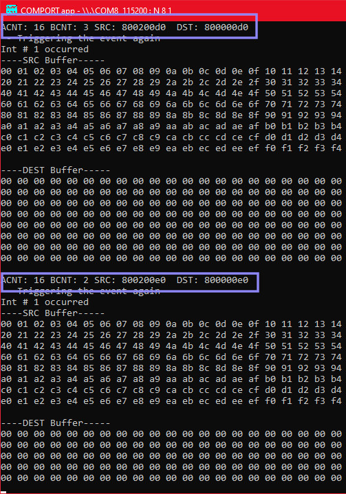

    This is a screen capture of the console output, showing that the source buffer is NOT being moved to the destination.  But the PaRAMS are changing from one interrupt to another.
    I am now at a complete loss.  I have been through the doc repeatedly.  I have internalized the entire EDMA3 module to the point I could almost assemble it from memory.  Except if I did, mine would work.
