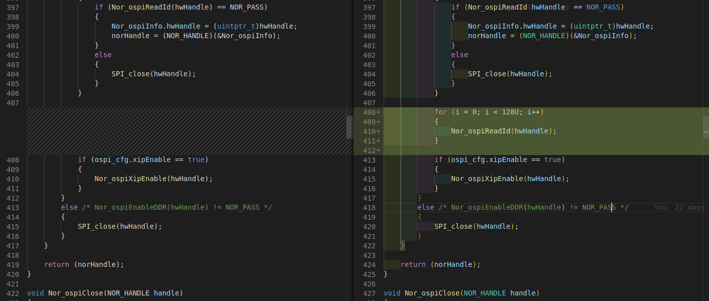

    2.I used the 133MHZ clock frequency and turned on the PHY, so after reading the flash ID 128 times through the PHY, the delay parameters in the PHY will be continuously adjusted to read the correct flash ID. However, because CYPRESS's volatile register and memory arry need to set different dummy cycles, and the delay parameter adjustment of phy is adjusted according to the flash ID, which is equivalent to adjusting the dummy clcle of accessing the volatile register, without adjusting the memory's dummy cycle. So now even if I read the correct flash ID, I cannot read the correct memory data.

    I did some modification in Nor_ospiOpen() and CSL_ospuConfigPhy() to disable data training and set to a fixed TX/RX values found in table 5-111 in DM. Then tried to read ID of Micron OSPI chip. Below is data gotten from OSPI_FLASH_RD_DATA_LOWER_REG  and OSPI_FLASH_RD_DATA_UPPER_REG with different rxLen set in NOR_ospiCmdRead().
    This test is based on OSPI_Flash_TestApp, other settings were not modified.

    I redo the test with data training enabled. HW: J7 EVM. SW: psdk_rtos_auto_j7_07_00_00_11. Just add Nor_ospiReadId() after calibrating PHY.
    During the test, I found that when read odd number of byte, the data gotten from OSPI_FLASH_RD_DATA register is correct. But when read even number of byte, the data gotten from OSPI_FLASH_RD_DATA register is different on each read. Please help to check if anything wrong in my test, Thanks.
