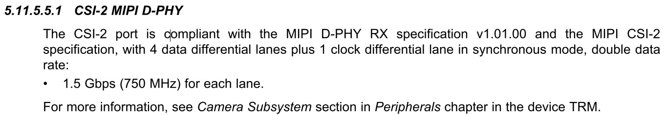

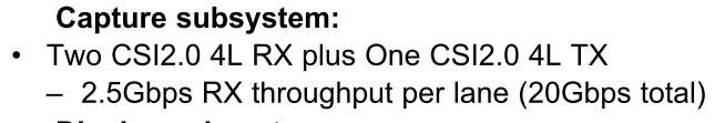

In the TDA4VM datasheet, SPRSP36E, there is a contradiction in the CSI2 RX throughput.
In section 1.1:
In section 5.11.5.5.1:
Can you please advice what is the correct value?

Hi Matan,
The description in section 1.1 is correct. It looks there are errors in later sections.. I will raise request to correct it.
Brijesh
