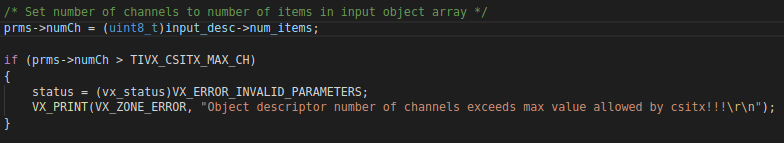

Our application contains the 4 cameras, and I want to use the CSI2TX node to transmit the data captured by theses cameras.
But while executing our application, we observed following error message.
VX_ZONE_ERROR:[tivxCsitxCreat:719] Object descriptor number of channels exceeds max value allowed by csitx!!!
While digging through this error we found following implementation in file vx_csitx_target.c, in function tivxCsitxCreate() , after looking at following code snippet ,
we found that maximum allowed number of channels are one, as TIVX_CSITX_MAX_CH is defined as (1U)
Query :
1. Can I use CSITX for multiple channel and if yes, how many number of channels are supported by CSITX?
