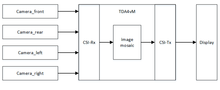

Can TDA4VM CSI2_TX port be used as the output after image mosaic(surround view camera)?

Yes, it can be used, but mosaicing needs to be done by other component, for example mosaic node..
