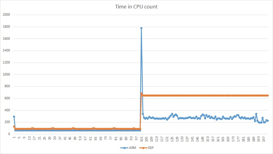

  • Hi Eric,
    Thanks for your information.
    I have added my testing code to your sample project (For DPS, since it is not BIOS project, I replaced it by my BIOS project and run the drystone test, I can get the similar result with you project). my observation is that:
    • DSP timing is more consistent than ARM.
    • DSP timing is larger than ARM, even the test code only involve calculation.
    Could you please advise how to exlpain the result, as we all know DSP calculation speed should be better than ARM? For the ARM timing, anyway to improve the consistency for the Real-time Application?
    My test result and test project are as below. Thanks a lot.
    WS_66AK2_Calc_W_Drystone_200709.zip
    Is that correct the figure you showed above is the cycles for your calc_test() and calc_test2()? This is not the Dhrystone?
    You test is data addition and multiplications and math functions in generic C code. I'm not sure the performance with such algorithm C66x vs A15. Maybe this is what you can get, or you can check how many cycles spends on each steps to understand which consumes more cycles. DSP code can be optimized with intrinsic which will greatly improve the performance, but this needs expertise.
    ARM A15 is a supersclar and in order instruction execution is not guaranteed. That may be the reason you see the fluctuation. You can add ARM barrier like dsb, imb, dmb to see if helps.
    Another angle is for you to check the A15 instruction cache and data cache usage, to see if any cache missing caused this. Your test code is small and it should fully cached, but I am not sure as you didn't delete the Dhrystone code, which was also runs.
    Regards, Eric

  • Hi Eric,
    Just suplement, the most important topic is why in my test result, the ARM is faster than DSP. Is it expected. So I would appreciate your help on the conclusion and exlaination on this topic.
    For the fluctuation on the ARM, it is also important but not as high priority as the performance comparation between DSP and ARM. Sorry if my previous post is not clear.
    Thanks a lot.
    Here is what I got on K2H DSP and ARM for your benchmarking algorithms:
      C66x   A15
     Iterations rgu32TimeSpend rgu32TimeSpend2 rgu32TimeSpend rgu32TimeSpend2
    1 119 2092 79 1814
    2 90 1651 33 338

    Yes, with conventional C code, C66x is slower than A15. (My C66x for rgu32TimeSpend2 is even slower than yours for some reason, also the C66x showed fluctuation).
    Regards, Eric

    The test code we both tried is generic C code. To improve the performance we need to rewrite with C66x intrinsic and use the MATHLIB for those math functions.
    When we use include <math.h>, those functions come from C66x run time library (rts6600_elf.lib), not the MATHLIB.
    I am checking if we have the code for SPRAC13.
    Regards, Eric

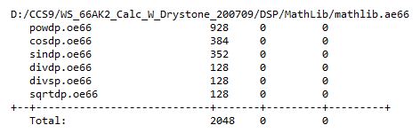

  • Hi Eric,
    I rebuilt MathLib with OVERRIDE_RTS flag and put mathlib.ae66 above lib.a, so when the same interface with normal funtion is used, it still be repalced by coresponding function from MathLib. We can vefiry it by the map file.
    Thanks.

  • Hi Eric,
    Follow your suggestion I have get the test code of Filter from DSPLIB and test with both DSP and ARM.
    Thanks.
