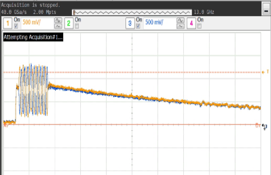

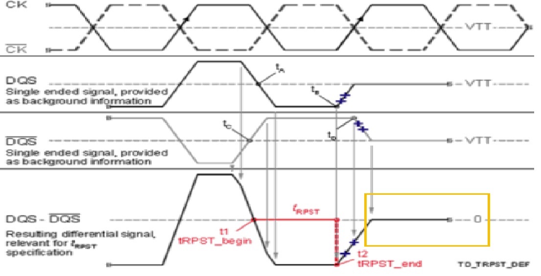

I suppose that DDR tRPST DQS diff test will stop on 0 V such as Orange frame on pic.1
pic1.

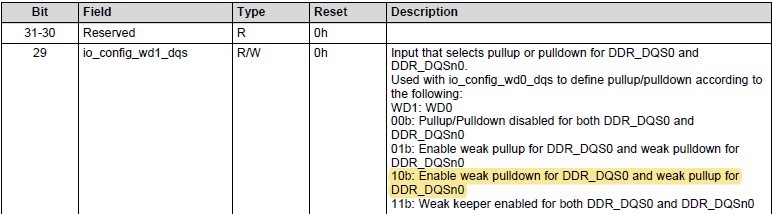

But the tail signal is not stop on 0 V in in actuality such as pic2

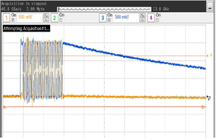

Check the signal by DQS diff
DQS(+) will not return to -VTT such as pic3 when Read.
pic.3: DQS diff. Read

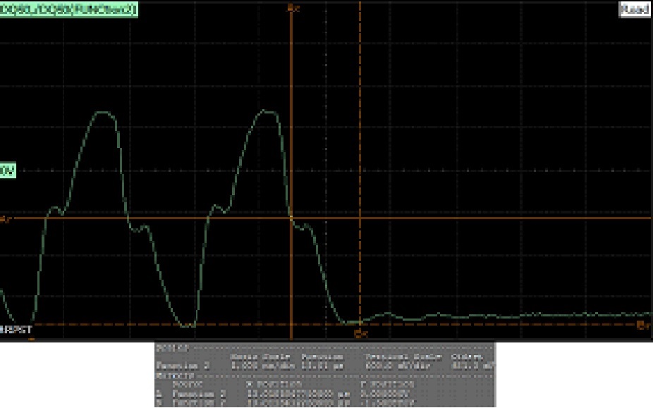

But Write signal is correct such as pic.4
pic.4 DQS diff. Write
Is the behavior correct or AM3352 setting issue??
Will the behavior cause any risk?
