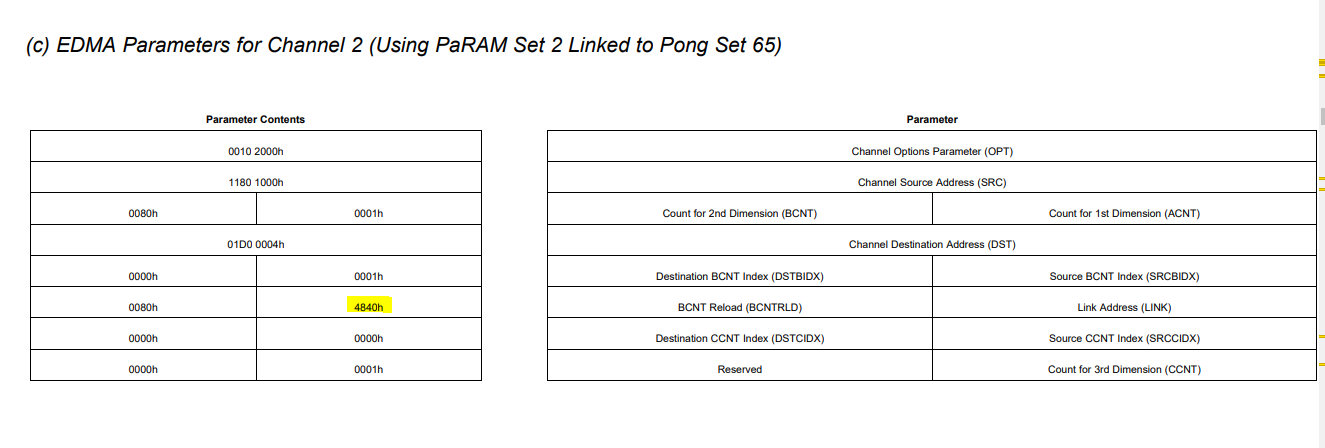

Is the link address of pong set 65 on TRM (page606) wrong? It should be 8420h.
Hello, there is a type-o but it is in the text at the top. It should read "(c) EDMA Parameters for Channel 2 (Using PaRAM set 2 Linked to Pong Set 66" Instead of 65.
Channel 2 links 66 and 67
Channel 3 links 64 and 65
