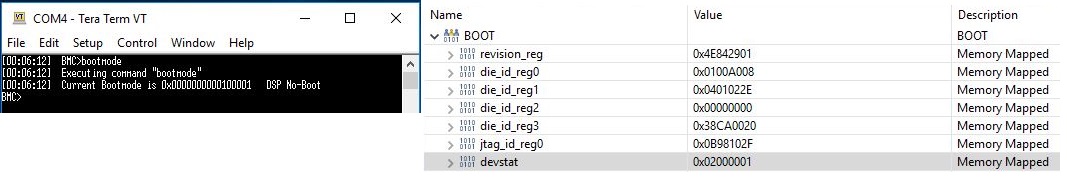

    For my new board, I set the switch to be SW1 - 1(OFF) 2(OFF) 3(OFF) 4(ON), the boot mode is as below:

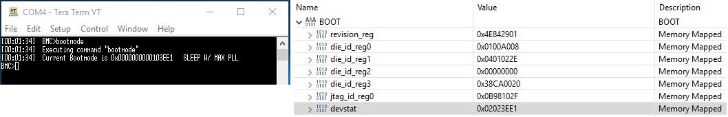

    For my previous board, when I check the DevStat, I set the Switch to be SW1 - 4(ON) 3(ON) 2(ON) 1(OFF), the bootmode is as below:

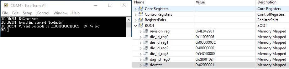

    I also try to change the switch on old board to SW1 - 1(OFF) 2(OFF) 3(OFF) 4(ON), and the bootmode is as below:
    Seems for both boards, when the swith is 1(OFF) 2(OFF) 3(OFF) 4(ON), they have the same DevStat value 0x02000001. Can I understand from your reply that for this bootmode, ARM will be clocked at 125MHz and SYS_CLK running at 122.88MHz?

  • Hi Chanh,
    That is correct.  The PLLs will be in bypass so the input clock frequencies should be used by the ARM and System subsections.
