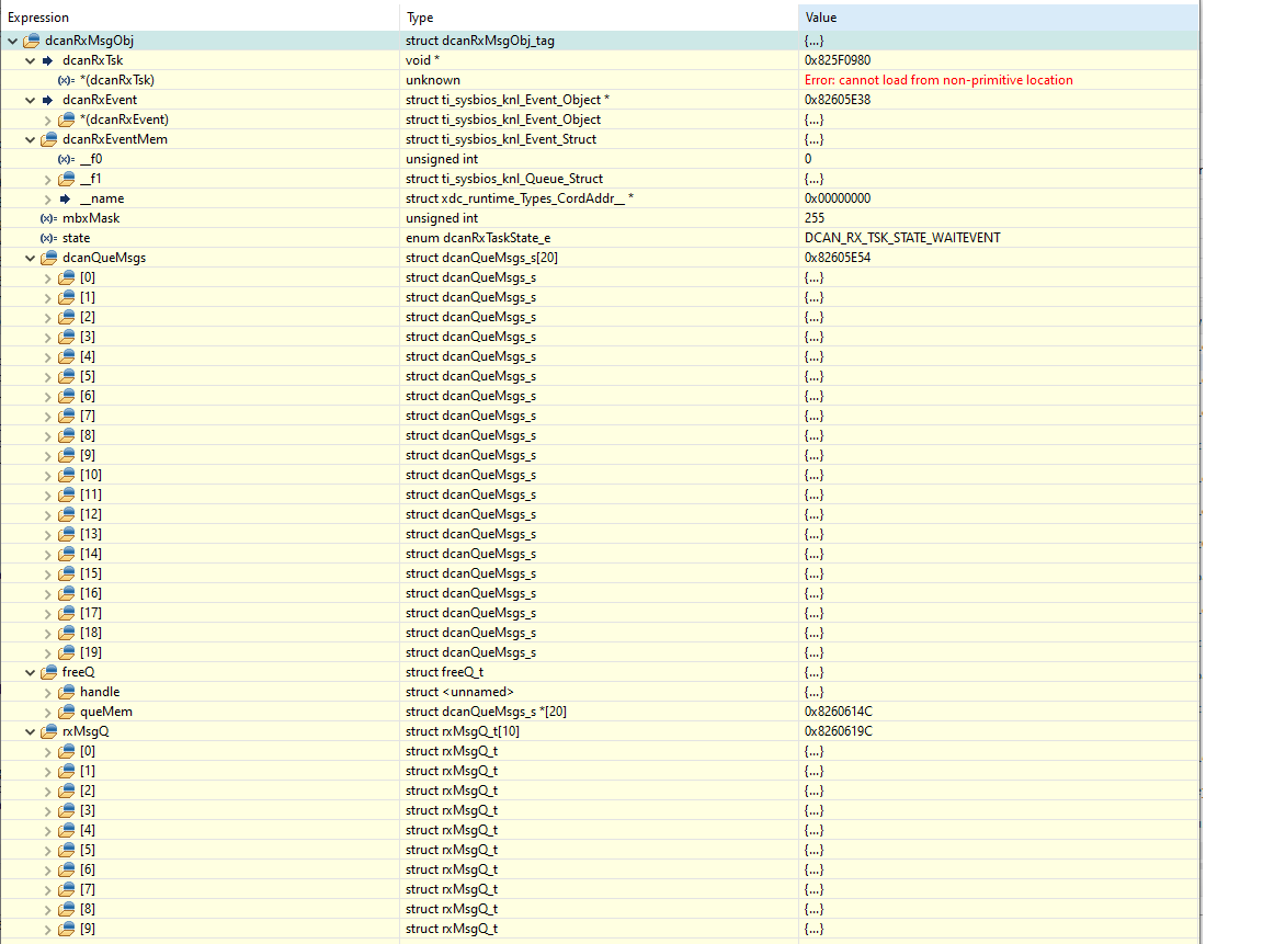

  • Hi Dmitriy,
    When your application is stuck inside 'Utils_dcanWrite()' function, can you please send me the DCAN register dump? Addresses are as follows depending on which DCAN module you are using:
    1. DCAN1: from '0x4AE3C000' to '0x4AE3C1F0'
    2. DCAN2: from '0x48480000' to '0x484801F0'
    Thanks & Regards,
    Vivek Dhande.
    Texas Instruments (India) Pvt Ltd
  • Hello Vivek
    I'm not really sure that I'm stuck in Utils_dcanWrite() function, nevertheless here is DCAN register dump. We are using DCAN1 module. Did I make it correct: I used Code Composer Studio Memory browser, and at the moment my programm stuck I used Save Memory function to create .dat file. In target options I set Start address as 0x4AE3C000 and length as 496 memory words. Format is 32-Bit Hex - TI Style. Is it OK?

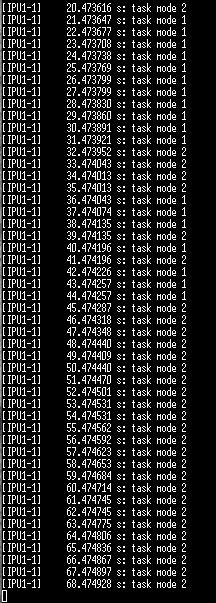

    Also I figured out that as expected after stuck I end up in Idle task end never go back to my task. Is that OK if I try to use my second task which is for checking 1st task state, as some kind of whatchdog task, and it will delete 1st task if it is blocked for too long time and create again in runtime? Can I do that? Something like this:

  • Hi Dmitriy,
    From the register dump, it looks like you don't have any outgoing or incoming message pending. This is the reason that task goes in Idle/blocked state.
    At what point did you take this register dump?
    Can you please answer the following questions (sorry for the inconvenience if I am repeating older questions):
    • Can you please provide message details (IDs) that are supposed to be received on TDA3x?
    • Same above for transmission.
    • Can you please also provide mailbox configuration details (especially for Rx)?
    Thanks & Regards,
    Vivek Dhande.

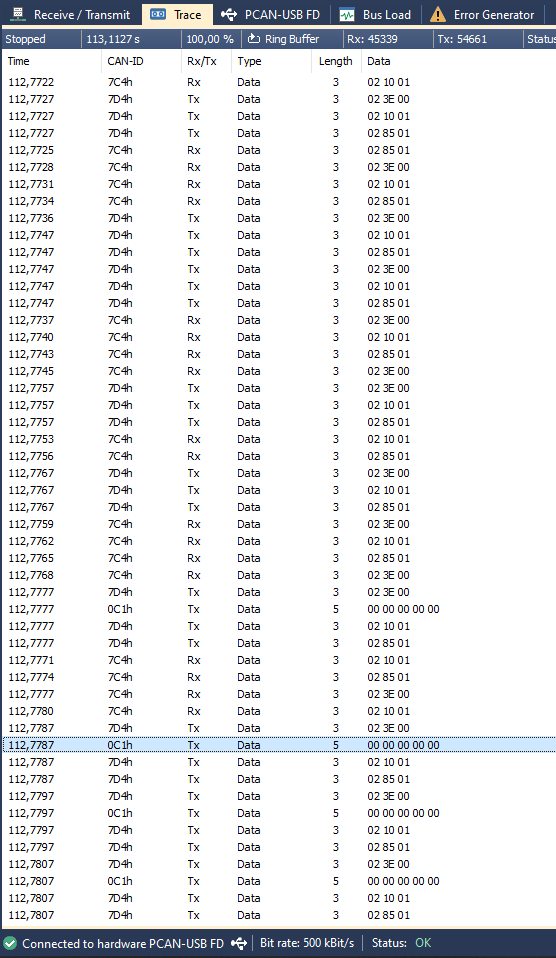

    I use ID 0x7D4 to send 3 different types of messages. Problems starts when I send one single message with some other ID. It could be any ID, both from init or not, for example it could be 0xC1. This is for Rx. For Tx we use only one ID - 0x7C4.
    I took that register dump exactly after I send 0xC1 message while sending 3 messages with ID 0x7D4. After receiving 0xC1 message Tx stoped, and after that I stoped to debug and took the dump.

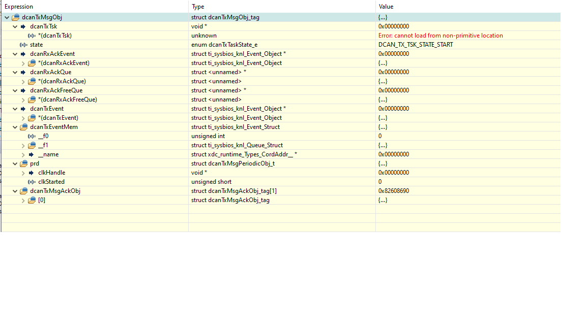

  • Hi Dmitriy,
    Thanks for the detailed response. From your last reply and earlier one with PCAN snapshot, when you send any ID apart from '0x7D4' from PCAN, TDA3 stops transmission.You send message with ID '0x7C4' from TDA3 when you receive message with ID '0x7D4'. Pleas correct if my understanding is wrong.
    Can you please check Rx, Tx handling on TDA3x? Especially for the scenario explained in your latest reply. What is the expected behaviour in this case?
    Also, is there any handshake between TDA3 and PCAN like PCAN responds to any message or it just sends out messages contuniusly w/o any ack from TDA3?
    Thanks & Regards,
    Vivek Dhande.
  • Hello Vivek.
    Yes, you understood it pretty well, TDA send 0x7C4 in responce on 0x7D4, and during that time if TDA receive some ID apart of  0x7D4, it stops transmission. But it happens only when there is at least two 0x7D4 messages per second.
    Can you please specify wich handlers do you need. Does it this handlers?
    This screenshots were take after stuck situation.
    About TDA and PCAN: PCAN continiously send 0x7D4 messages and recieve any messages from TDA, there is no other connection between them. Its like a stress test for TDA. We trying to make TDA works with overloaded CANbus.
    Actually, I think I figured out what is blocking my task. Apparently, it have been blocked by BspOsal_semWait function, which is called in  Utils_dcanWaitForTxComplete. BspOsal_semWait have 'dcanTxMsgObj.dcanTxMsgAckObj[txMbxIndex].semTxComplete' as input paramenter, and in my situation txMbxIndex is equal to 0. That function timeout is BSP_OSAL_WAIT_FOREVER. So when I post that semaphore in additional task (after 1st task blocked for a certain time), which is checking 1st task state, everething continue to work well. But this doesnt really solve the problem.
    Best regards, D.K. Tovmachenko.

  • Hello Vivek.
    As I said before, I created the task which purpose is to check state of my primary task. If primary task is blocked for too long time that task post semaphore. By debuging in CCS I figured out, that my primary task is blocked somewhere in utils_dcan.c function Utils_dcanWaitForTxComplete(UInt32 txMbxIndex). In that function there is only one resource that can block task - BspOsal_semWait(). Obviously, that function pend semaphore somewhere inside, and it takes handler of that semaphore as input parameter. By printing txMbxIndex in runtime I got that index - 0. So I created function which post that semaphore and use it in my watchdog task. It turns out, my watchdog task implicitly change that semaphore timeout to timeout I determine in my task. That way my programm works well by now, but it doesnt solve the problem, I still dont know why does my task get blocked and how can I unblock it without using the crutch.
    Regards, D.K.Tovmachenko.
