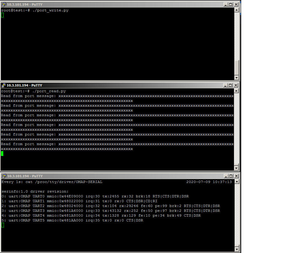

    Results for SERIAL_OMAP driver, characters are send to port 3 and received on port 2:
    Results for SERIAL_8250_OMAP driver, characters are send to port 3, but not received on port 2:
    I've also tested communication on ports using compiled .c code from the link.
    Results for SERIAL_OMAP driver, bytes are send to port 3 and received on port 2:

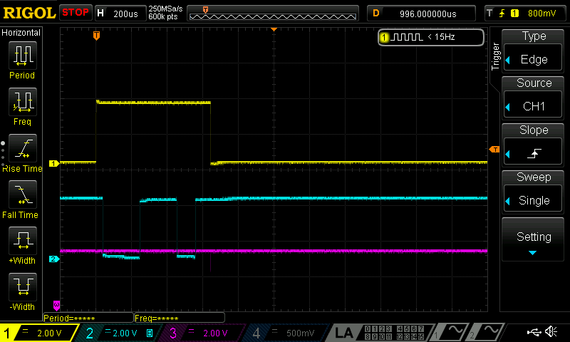

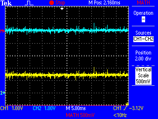

  • Hi Bin,
    Yes, it seems that both Python and C codes work fine as verification tests.
    Regarding scope captures, first one is probed on transceiver pins, next two are probed at the AM3352 UART pins before RS-485 transceiver, during failure and normal communication.
    Our next important observation is that issue is reproducing more frequent when baudrate on the bus is changed more frequent e.g. 115200 -> 19200 -> 115200 etc. We need to change baudrate, to query other types of devices connected to the same bus.

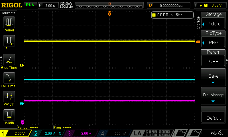

    Failed /dev/ttyO5 port:
    In the initial state RTS is high. The state is from the previous attempt to send data.
    RTS - yellow, TxD - blue, RxD - magenta

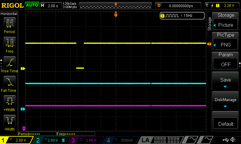

    Then with the below script it was possible to change RTS to low:
    #!/usr/bin/env python3
    import time
    import serial
    import serial.rs485
    port = serial.Serial('/dev/ttyO5')
    port.rs485_mode = serial.rs485.RS485Settings()
    port.stopbits = serial.STOPBITS_ONE
    port.bytesize = serial.EIGHTBITS
    port.parity = serial.PARITY_EVEN
    port.timeout = 5
    port.baudrate = 19200
    port.rts = False
    time.sleep(1)
    port.write('x'.encode('utf-8'))
    port.flush()
    port.rts = False
    After 1 second script is trying to send data. RTS is going high, but script hangs and next instruction to change RTS again to low was not executed. It should be set to low even without it after finishing data transmission. It was needed to stop script with Ctrl-C. After stopping script, states of pins remain unchanged:
    So in a failure state RTS can work, but TxD not.
