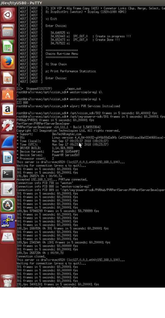

    one question, we tested weston-simple-egl demo on TI J6 EVM. log shows 60 fps. would you please tell us how to calculate this fps?
    root@dra7xx-evm:/opt/vision_sdk# weston-simple-egl &\
    [2] 888
    301 frames in 5 seconds: 60.200001 fps
    Thanks a lot!

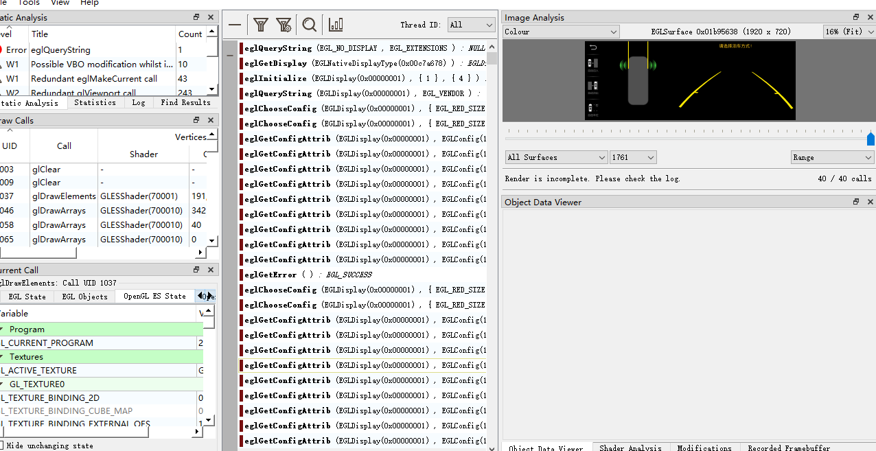

    Thank you for the trace. I can see the UI rendered along with some lines but no textures. Is it possible for you to provide a trace with TEXTURE_2D instead of TEXTURE_EXTERNAL_OES. This is only for debug.
    Can you also open this trace in PVRTrace GUI and confirm if the output looks okay?
    Hemant

     Yes, we open it in PVRTrace GUI, it can show parts of the log file, see the log
    as the GUI only show the parts of the log, in that scene, the camera data is not load.

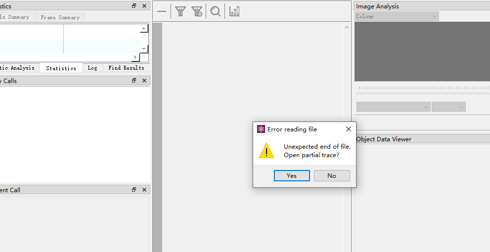

    for the unexpected EOF, we find it's the bug of PVRRecorder, we tried the latest version 2019R2, that not work. only the revision in PSDLA 6.03 works.

    Tried to use PVRTraceGUI 3.10 and PVRTraceGUI3.13 to open the PVRTrace log, ecarx.log-GL_TEXTURE_2D.rar. Still find the prompt dialog "unexpected end of file, topen partial trace?". So please check if the log is good for your check.
    and aligned with customer, they used the build-in img-powervr-sdk from PSDKLA 6_00_00_03 to capture that PVRTrace log.
    detail of the img-powervr-sdk folder like below. I only can print the version of PVRPerfServerDeveloper.
    if the log is not enough, please help guide us to capture good PVRTrace log. for example, which version of PVRTrace record tool can be used?
