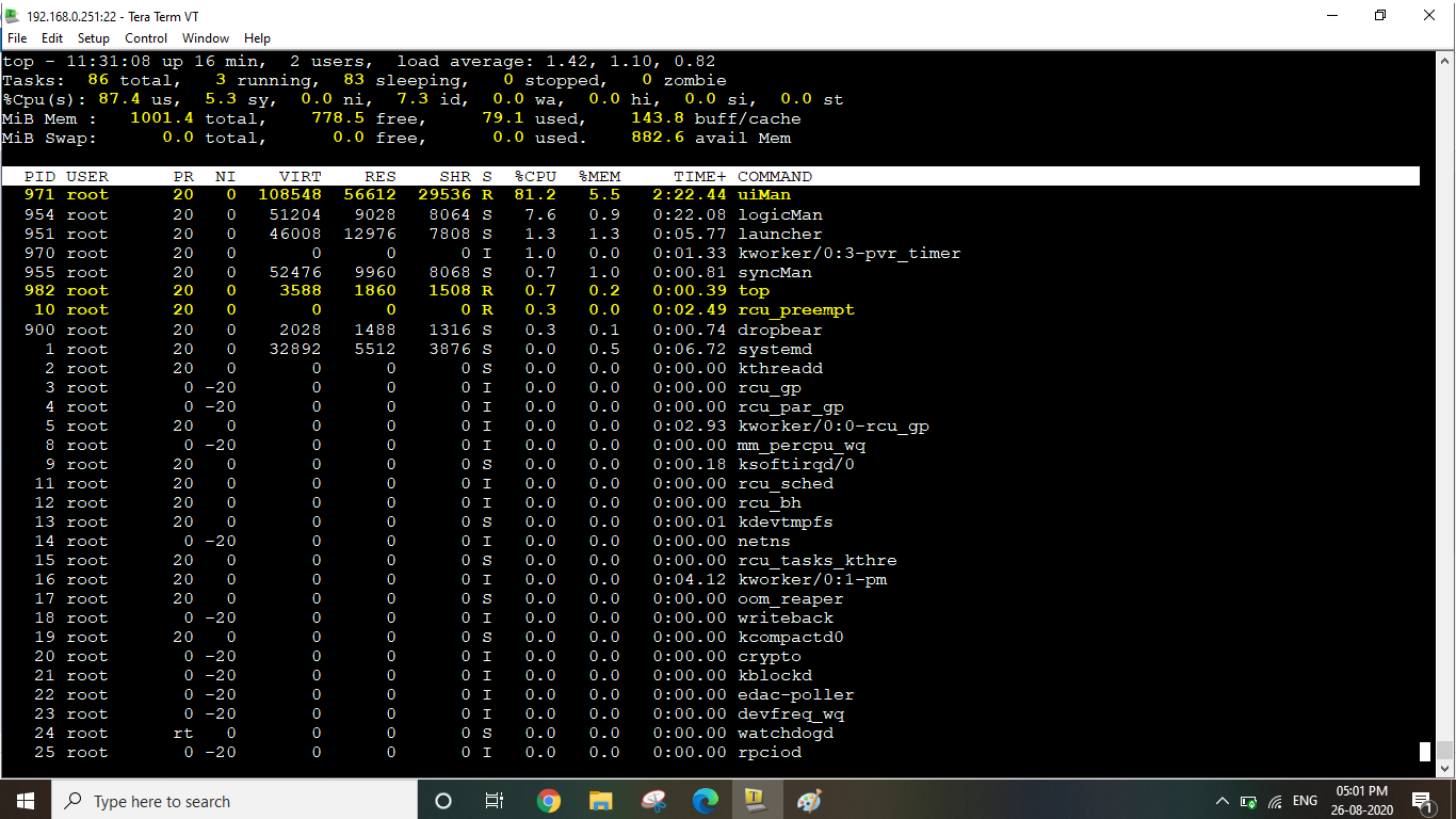

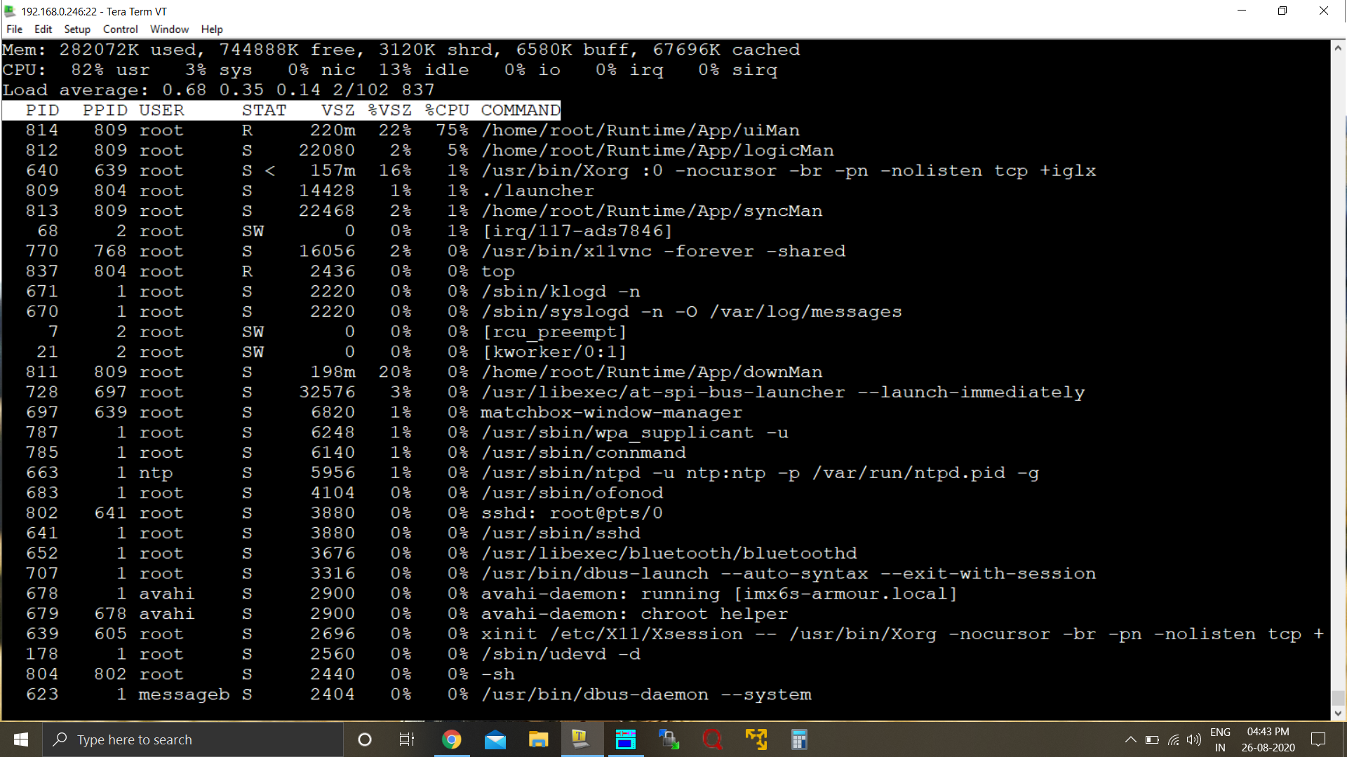

We have custom board with display resolution 800x480. We are using standard SDK 6x and compiled Qt widget application (not QML) to check benchmark performance. So we have multiple screens with multiple Qt objects on screen (say 300 different objects). So if we compare performance of same application with NXP iMX6 Solo then TI AM4378 performance looks sluggish so we are expecting similar kind of performance as iMX6 Solo because both processors have almost same specifications like Cortex A9, 1 GHZ, 1 GB DDR etc etc. So differences between two system are mentioned below
- iMX6 with x11 and TI AM4378 with Wayland
- iMX6 with eMMC boot and TI AM4378 with SD boot
So what could be the possible reasons for performance difference between two processor? Also we observed 'sync' command sometime becomes quite sluggish but we never observed such problems with iMX6 Solo with x11. This is due to SD boot or Wayland platform?
What we have decided
- Make TI AM437x with x11 but in this case need to check SDK  which supports x11 (ti-processor-sdk-linux-am437x-evm-04.01.00.06-Linux-x86-Install support x11?)
- Boot with eMMC as similar to iMX6 Solo
What we can check other parameters to get root cause of performance differences between two processor? We believe TI AM4378 has similar capabilities compared to iMX6 Solo
Thanks and Regards
Pravin Yadav

  • Hello Pravin,
    Thank you for providing your application and while running the app, I noticed that the CPU usage is high (100%). I do not think that should be the case and I am internally checking with our developers. This could be a potential difference between the two setup.
    Krunal

  • Hello Pravin,
    Based on my internal discussions, the hardware acceleration is disabled for QtWebengine browser on PSDK6.x and if possible, we recommend using QtWebkit. With regards to Qtwidget, it uses software rendering by default and I am wondering if the goal of your application is to use CPU or GPU for rendering. Also, due to the dss underflow issues (silicon errata: Advisory 14 DSS: DSS Limitations), we limit the ARM bandwidth to 700MB/s and here is the Uboot config. As an experiment, feel free to increase the ARM BW and see if it helps with SW rendering.
    Krunal

  • Hi Pravin,
    Could you please share the CPU usage for the iMX board where you observe the best performance? While running the application, please run the "top" command.
    Krunal
  • Also, could you please share the code that allows you to measure the time it take for CPU to copy the image?
    Krunal
  • Hi Krunal,
    Please find attached screen shot for both system
    We calculated time using Qt stop watch mechanism. Also this switching time is visible to us means 1 seconds for Solo and almost 2 seconds (1.80 seconds) for TI.
    TI CPU Usage
    Solo CPU usage
  • Hi Pravin,
    Thank you for the snapshots.
     Is there a way you could share the code/method for running the Qt stop watch? We are trying to run more internal tests and we would like to benchmark the applications based on your setup. Also, the application loads two images, "Next" and "Previous". Does it take 2 seconds to load from "Next" to "Previous" or from "Previous" to "Next"? On my setup, I see it takes more time to load from "Previous" to "Next" and wanted to confirm that you see the same behavior.
    Krunal
