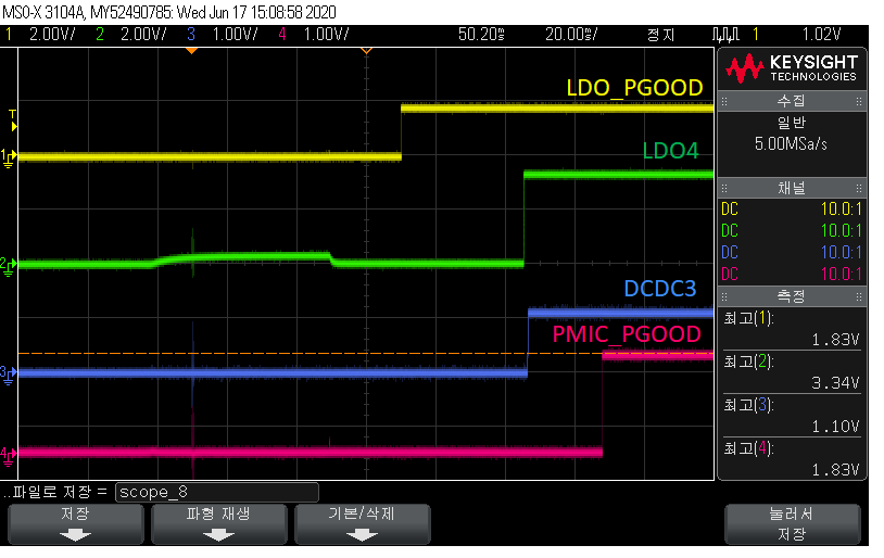

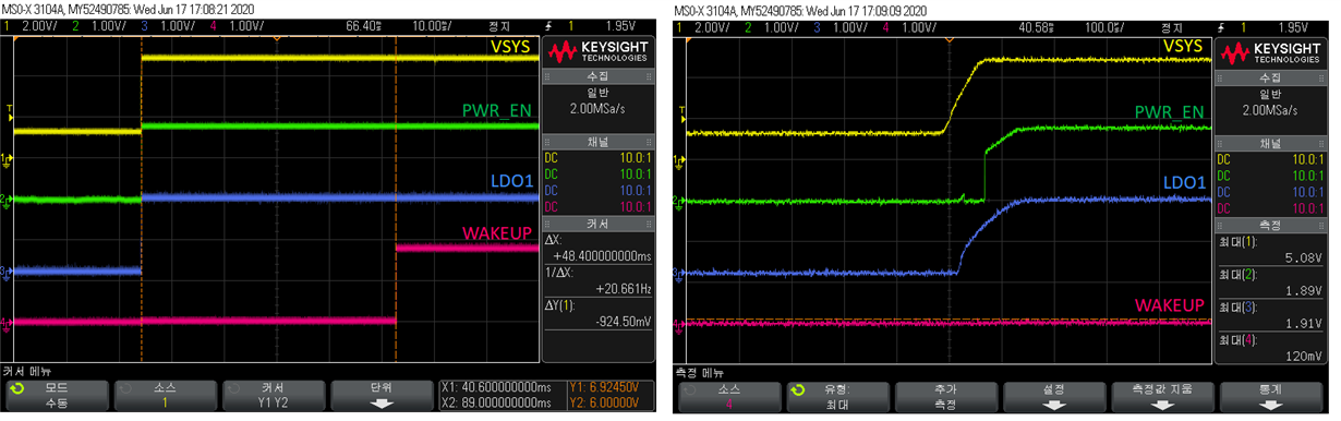

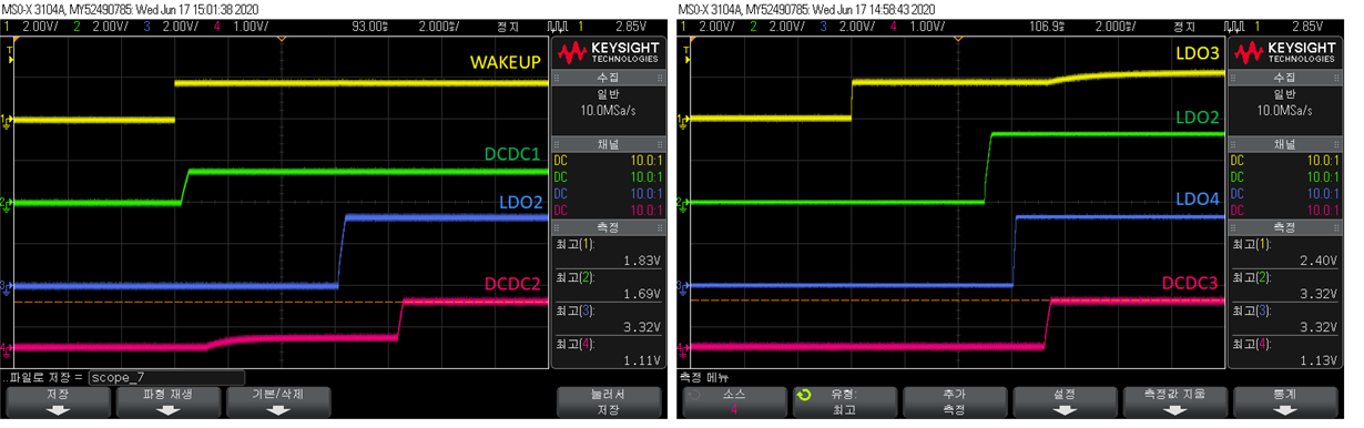

    I attach power sequence wave form.
    I think  this is no problem compared to other mass-produced models

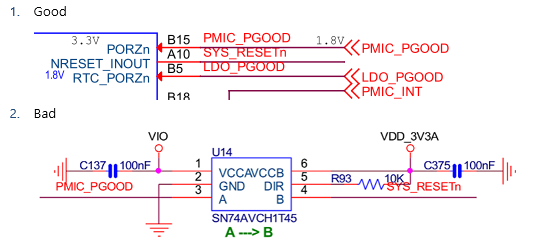

    The difference between mass-produced model and board has booting issue is the reset circuit.

    Can you post a schematic extract that shows all the connections between the SoC MMC1 peripheral interface and the external eMMC device, including any power and reset connections?
