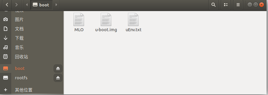

I have a AM5728 custom board.
I use  ti-processor-sdk-linux-rt-am57xx-evm-06.03.00.106-Linux-x86-Install.bin.
I split the sd card's partition into two partitions via create-sdcard.sh provided by sdk (16GB capacity).
Available Drives to write images to:
# major minor size name
1: 8 0 351641304 sda
2: 8 32 15286272 sdc
Enter Device Number or n to exit: 2
sdc was selected
/dev/sdc is an sdx device
Unmounting the sdc drives
unmounted /dev/sdc1
unmounted /dev/sdc2
Current size of sdc1 71680 bytes
Current size of sdc2 15197184 bytes
Select 2 partitions if only need boot and rootfs (most users).
Select 3 partitions if need SDK & other content on SD card. This is
usually used by device manufacturers with access to partition tarballs.
****WARNING**** continuing will erase all data on sdc
Number of partitions needed [2/3] : 2
Now partitioning sdc with 2 partitions...
Now making 2 partitions
1024+0 records in
1024+0 records out
1048576 bytes (1.0 MB, 1.0 MiB) copied, 0.261054 s, 4.0 MB/s
DISK SIZE - 15653142528 bytes
Partitioning Boot
mkfs.fat 4.1 (2017-01-24)
mkfs.fat: warning - lowercase labels might not work properly with DOS or Windows
mkfs.vfat: unable to open /dev/sdc1: No such file or directory
Partitioning rootfs
mke2fs 1.44.1 (24-Mar-2018)
/dev/sdc2 contains a ext3 file system labelled 'rootfs'
last mounted on /media/skyliqf/rootfs on Wed Jul 8 11:17:21 2020
Proceed anyway? (y,N) y
Creating filesystem with 3799296 4k blocks and 950272 inodes
Filesystem UUID: 30ceebdb-9acb-4dae-aeef-33f268435240
Superblock backups stored on blocks:
32768, 98304, 163840, 229376, 294912, 819200, 884736, 1605632, 2654208
Allocating group tables: done
Writing inode tables: done
Creating journal (16384 blocks): done
Writing superblocks and filesystem accounting information: done
Partitioning is now done
Continue to install filesystem or select 'n' to safe exit
**Warning** Continuing will erase files any files in the partitions
Would you like to continue? [y/n] : y
Mount the partitions
Emptying partitions
Syncing....
Choose file path to install from
1 ) Install pre-built images from SDK
2 ) Enter in custom boot and rootfs file paths
Choose now [1/2] : 1
Will now install from SDK pre-built images
now installing: AM57X_RT
Multiple rootfs Tarballs found
1:tisdk-rootfs-image-am57xx-evm.tar.xz
2:tisdk-docker-rootfs-image-am57xx-evm.tar.xz
Enter Number of rootfs Tarball: 1
Copying files now... will take minutes
Copying boot partition
MLO copied
u-boot.img copied
uEnv.txt copied
Copying rootfs System partition
Syncing...
Un-mount the partitions
Remove created temp directories
Operation Finished
but board doesn't recognize the SD card in U-Boot, the kernel and device tree loading is failing.
Could you tell me why?

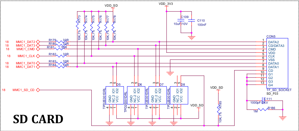

SD Card part of schematic:
    Did you update u-boot dts with changes for your board?

       I dont update dts.
    I changed the resistance R186 to 0 Ω, and SD card can be found, but there are new problems.

    Based on your board schematics the kernel dts needs to be updated to reflect that.
    Vishal
  • I reviewed the schematics and recommend the following changes:
    1.  Use 47 kohms for PU and remove PU resistor from MMC1_CLK path
    2.  Use the same 3.3 V rail for SD cage for TPD2E001 VCC; also add a 0.1 uF bypass capacitor on each rails
    Have a great day!
    Shiou Mei
  • Hello , Vishal
    What is wrong with my board and how can I solve it ?
    Could you please look at the inputs provided by Shiou Mei on the hardware schematics?
    Vishal
  • I modified the hardware schematic according to Shiou Mei's suggestion, but to no avail.
    Could you share your kernel dts file?
    Vishal

  • In your dts, vmmc-supply looks wrong. Can you put the correct vmmc-supply value. According to your schematics it should be a fixed 3.3v regulator.
    vmmc-supply -- The Vdd voltage supply for the card
    Vishal
  • I measured vmmc-supply is 3.3V, mmc1_clk works about 830kM
