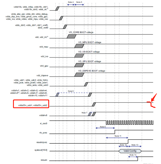

We are not using the USB function of TDA2
What will happen if we turn off this power supply of TDA2 after the SOC completes the power-on sequence?
VDDA33V_USB1 & VDDA33V_USB2

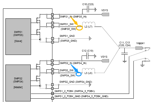

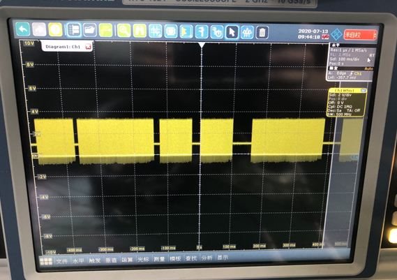

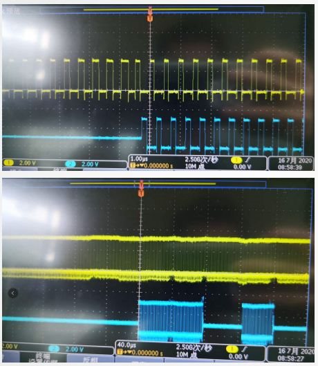

The PMIC power to the MPU through SMPS1 and SMPS2. Under normal circumstances, the port SMPS should continue to output 2MHz switching waveform, but sometimes we find that the switching frequency is stagnant, as shown in the figure :
We are worried that this method will affect the RE, so I would like to consult which PMIC registers can be improved or optimized?
That's expected operation. Here is a quote from the PMIC Datasheet:
In dual-phase configuration the two interleaved synchronous buck regulator phases with built-in current sharing operate in opposite phase. In triple-phase configuration the three interleaved synchronous buck regulator phases with built-in current sharing operate 120° out of phase. For light loads, the converter automatically changes to 1-phase operation.
Kyle
Hi,Kyle
What kind of damage may occur to SOC? Is it possible that the SOC power consumption is abnormal?
Which document describes this content?
