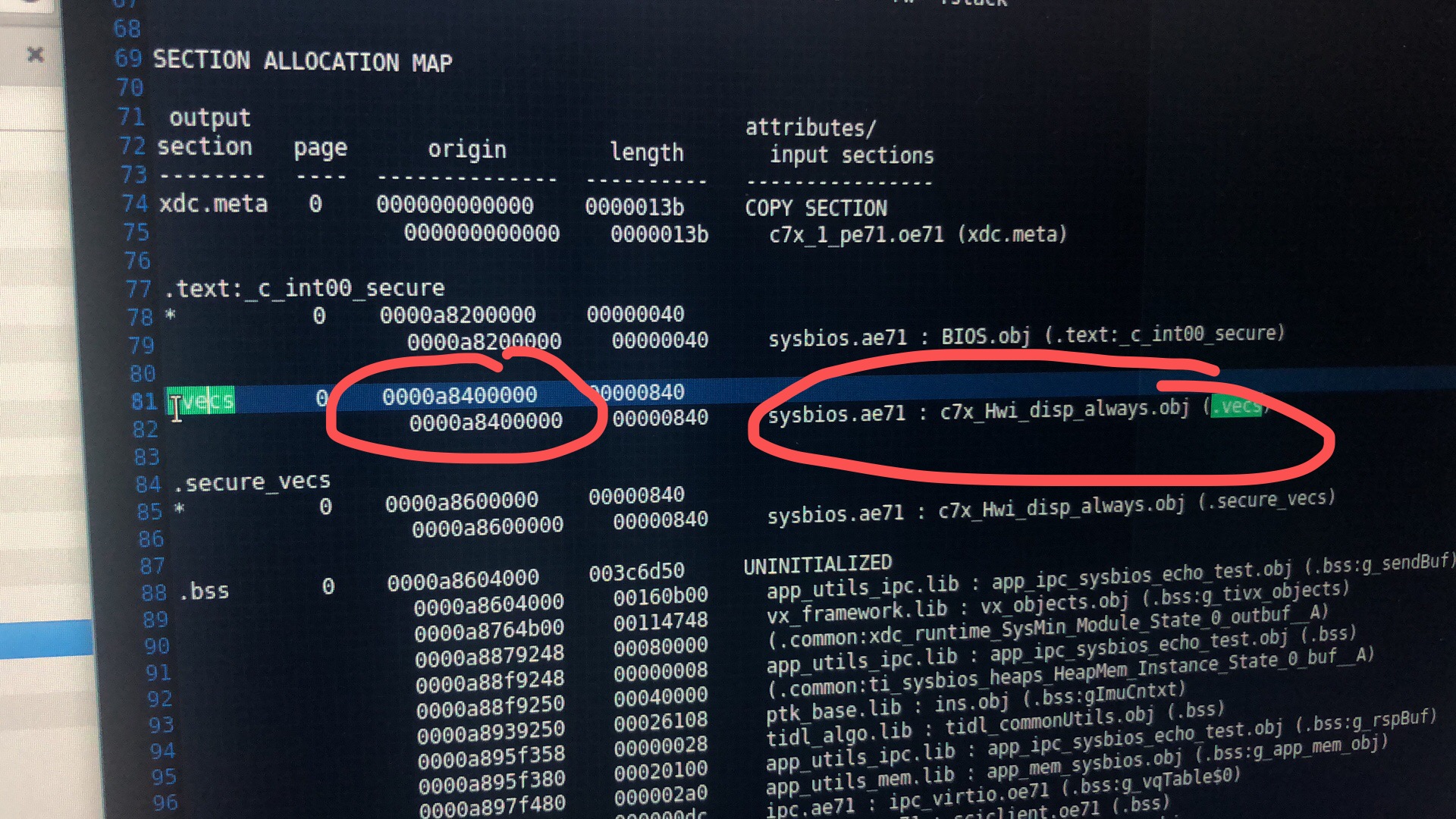

I am helping one of our customer with C7x abort issue: after a long time(5~10hrs) test, C7x will abort.
When we use JTAG connect to C7x, we find that C7x is stuck at "int_exec".
bios_6_76_03_01/packages/ti/sysbios/family/c7x/Hwi_disp_always.s71 line 183:
int_exc:
b.b1 $PCR_OFFSET(int_exc)
How can we find more information to do further debug? Can we find out the backtrace/call stack?
