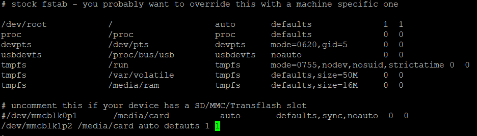

    If you want to control the behavior of partitions, you need to add an entry to the /etc/fstab file on file system and give appropriate options.
    Try adding below and see if it changes any behavior (The last option 0 says disable fsck)
    /dev/mmcblk1p1       /media/card          auto       defaults,sync,noauto  0  0

  • Hi Vishal,
    The board is booting from sd card (the root file system is on mmcblk1p2).
    I have a specific requirement that, on every boot fsck(file systecm check) should be done on mmcblk1p2.
    Can you please let me know what can be done to achieve this.
    Sainath
    PS) I have tried by writing the last line in /etc/fstab as below: But I did not any thing such as file system check run on mmcblk1p2 in kernel boot logs.
    So question is different now.
    Instead of avoidinf file system check now you want to run file system check.
    I think for rootfs it's automatically run. You don't see it in Kernel logs?

    After adding /dev/mmcblk1p2 in /etc/fstab file, "started file system check on /dev/mmcblk1p2" is printed in the kernel log. Please find the attached log file.
    But, if I run: tune2fs -l /dev/mmcblk1p2 | grep Last\ c
    command after the board is up. Then it is printing as below: the last checked date is not updated.  Is there any other way to check the last fsck checked date.
    And one more point is: I want to force fsck to happen irrespective of the dirty flag on every boot.

    [    7.062546] EXT4-fs (mmcblk1p2): warning: maximal mount count reached, running e2fsck is recommended
    [    7.075339] EXT4-fs (mmcblk1p2): recovery complete
    [    7.080717] EXT4-fs (mmcblk1p2): mounted filesystem with ordered data mode. Opts: (null)
    [    7.088805] VFS: Mounted root (ext4 filesystem) on device 179:98.

    [    7.649710] systemd[1]: local-fs.target: Found ordering cycle on media-card.mount/start
    [    7.657722] systemd[1]: local-fs.target: Found dependency on myfsck.service/start
    [    7.665195] systemd[1]: local-fs.target: Found dependency on basic.target/start
    [    7.672498] systemd[1]: local-fs.target: Found dependency on sockets.target/start
    [    7.679968] systemd[1]: local-fs.target: Found dependency on dropbear.socket/stop
    [ SKIP ] Ordering cycle found, skipping /media/card

  • Hi Sainath,
    Don't know the exact answers, will have to look around.
    These are generic fsck related questions which are not TI specific.
    Vishal
