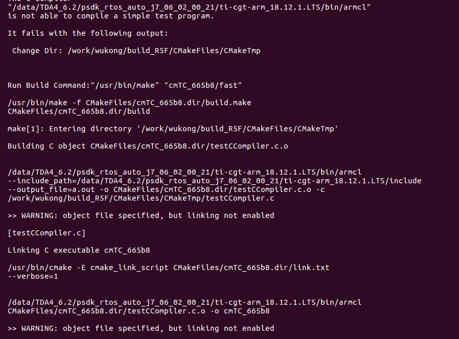

Can you take a look at this E2E post ? and also post your makefile ? If you are compiling on Linux then it's make command only, not cmake.
I don't have any examples readily available but you can take a look at the I2C utility app inside PDK which has only one file.
See pdk_jacinto_07_00_00/packages/ti/drv/i2c/example/i2c_utility
