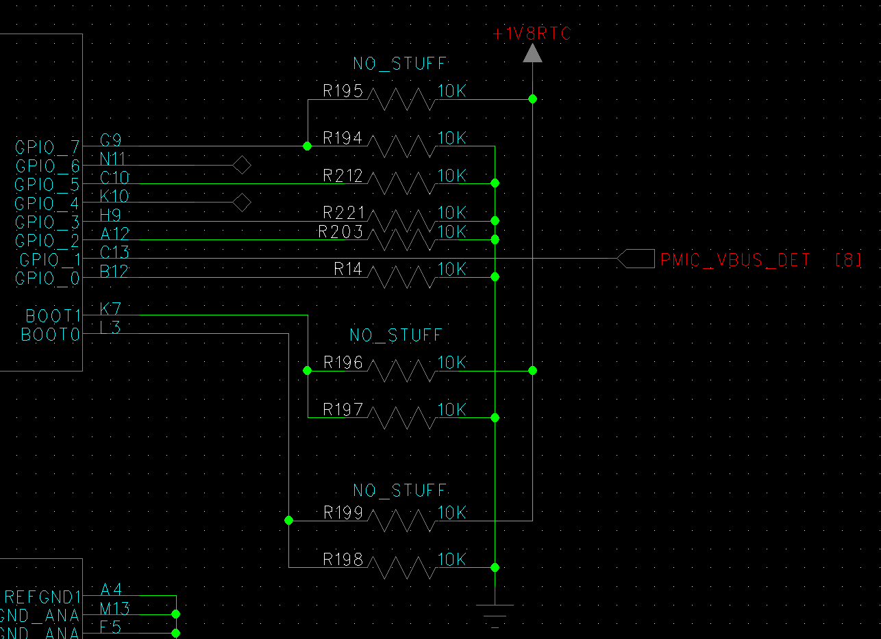

  • Yes, our board design is originally modeled on the the AM5728 EVM/BeagleX15, but it is about 30% larger (there is an FPGA and a bunch of A/V related parts/IO etc.) and with a somewhat different peripheral layout.
    ---Chris
  • Also FYI the referenced PMIC GPIO_7 line is grounded (via 10K resistor) on our board - so it's not clear how any reprogramming at boot time would have an effect.
    ---Chris

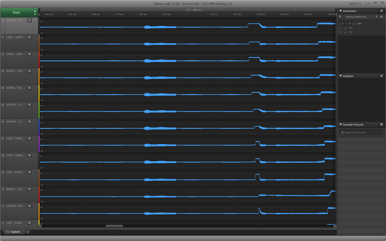

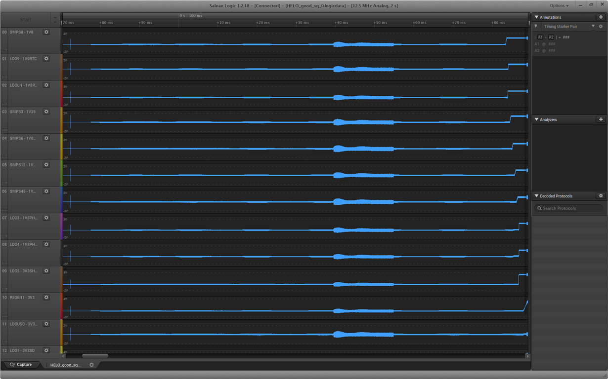

  • Here is some detailed analysis of what we're seeing with this. Pretty clearly the new firmware is inducing a power sequencing issue, because all the rails come up for 5ms or so except for the 3v3 rail which is only partially up; then they drop and come back again after ~20ms. Clearly wrong, and this only happens when booting to the new SDK.
    Attached are traces for both the good/old firmware and the bad/new firmware on the same board.
    Old firmware is u-boot and kernel from 02.00.01.07 SDK, new is from 06.01.00.08 SDK kernel with identical (old) u-boot.
    Please advise.
    Here is the good power-on, using old firmware:
    And here is the bad one, using same board, new firmware:
  • The issue is due to a reset of the PMIC which is forced by the Linux driver after the kernel loads, due to the default new feature 'ti,palmas-override-powerhold' being present in the DTS for the TPS659037 driver and on our board PMIC GPIO7 is always held low; this triggers an immediate PMIC reset when the driver loads with the override feature enabled. Removing 'ti,palmas-override-powerhold' from the device tree allows the system to start normally with no changes to the older u-boot.

    5) Using a bus probe on the PMIC I2C shows that the kernel write patterns for the PMIC are completely different between the old and new kernels. I have detailed, very large dumps of this if they would prove useful, I can post them at your request.
    I've attached below the line all the data in the register comparisons shown above.

  • Hi Chris,
    I did a diff on your two kernel logs, and didn't really see anything alarming in the bad case.
    Few follow-up questions:
    1) is your reset button tied to the warm reset input on the PMIC?  On our EVM, we have a DNI resistor in this path, so the push-button reset will only reset the processor.  Wanted to confirm if your reset button is resetting both PMIC and processor, or just the processor.
    2) it looks like when the PMIC reset occurs, REGEN1 does not go back to 0V, rather sits as some mid-supply value (looks like about 1v?).  On our EVM, this is supplying the main 12v to 3.3v buck.  If your board is implemented in the same way, does the 3v3 regulator get enabled by this runt pulse?  And if so, does it stay up while the other supplies are reset?
    3) can you confirm the PMIC reset is occurring in Linux, or u-boot?  Looking at the time stamps, it is not clear if T0 begins at power-on, or if you're triggering on something else and the time scale should be considered relative.  I'm asking because the best action would probably be to modify the driver such that this reset does not occur, and need to understand if the Linux or u-boot driver needs the patch.
    4) are there any other changes to the layout from the AM5728 EVM, especially related to power supply and reset to the processor?  If you happen to know which revision of the EVM your schematics were based on, that information might help as well, just in case we made some changes over time.
    Mike
  • Hi Mike,
    In answer to your questions above:
    1) The PMIC warm reset is not connected to the reset button. PMIC warm reset is driven only by the AM5728 reset out.
    2) In our design REGEN1 drives the enable on a TPS22920 that switches the 3.3V rail to the majority of the board, including the AM5728. 1V is between the high and low thresholds of the enable so it may be on, off, or partially on.
    3) I haven't probed for this explicitly at the signal level, but given the fact that u-boot is the same, and running the old SDK kernel does not cause the reset, I think it's safe to assume that the new SDK kernel is what initially causes it. However, also recall that once the failure mode has occurred, the same behavior happens even when booting to the old SDK again (without a long rest period) so something peculiar happens as a result of the first reset which persists the condition.
    4) No EVM schematic was available from TI when we started this design. TI put us in contact with a designer at BeagleBoard who provided the schematic for the BeagleBoard-X15, dated May 2015. We later incorporated changes from the Rev A2b EVM schematic, dated October 2015.
    ---Chris
  • Chris,
    Thanks for answering all my questions!
    Can you get a scope capture as you provided in the past the shows REGEN1 and the main 3V3 supply during the bad case?  If the 3V3 supply remains up during the PMIC reset, this is a problem and can be a cause for what you're experiencing.
    The load switch data sheet lists the minimum VIH spec at 1.1V.  This is right on the edge based on your sequencing trace in the bad case.  REGEN1 should be push-pull by default, and not sure why this output does not get pulled down.
    I will dig into the Linux PMIC driver, and see if we can provide a patch that will disable the PMIC reset.
    There is also some concern that the processor may not be shutting down when die temp reaches 125C.  Do you have a way to measure the temperature (thermocouple, IR probe, etc)?  There is a notice in the errata (i827) that would be worth looking at:
    i827 Thermal Alert Will Not Be Generated When Bandgap Is Configured in "Smart Idle" Mode
    CRITICALITY Low
    The MPU will not receive an interrupt request for thermal alert (MPU_IRQ_126) if the MPU bandgap cell is in idle mode. When the MPU bandgap cell is in idle state (CTRL_CORE_BANDGAP_MASK_1[31:30] SIDLEMODE=0x2), the MPU bandgap state machine can not send THERMAL_ALERT signal and MPU interrupt request, respectively.
    GUIDELINES Do not idle the Control Module MPU Bandgap (keep CTRL_CORE_BANDGAP_MASK_1[31:30] SIDLEMODE=0x0)
    REVISIONS IMPACTED SR 2.0, 1.1
    Mike

    Meanwhile, can you please verify that the attached PMIC schematic section is correct for our situation (no power button, power applied will sequence all the rails correctly), and that the PMIC GPIO assignments have not changed since SDK 2.0.1.7?
    ---Chris
  • Chris,
    Apologies for the long dela while I was out of the office.
    Your schematic is inline with the X15 and AM5728 GP EVM.

  • Attached are CSV files of i2c captures from 4 scenarios:
    good-old1.csv - startup with old firmware, no runaway.
    good-new1.csv - first startup with new firmware, no runaway, but subsequent starts of new or old FW will runaway
    bad-new1.csv - re-power new FW after good-new1, runaway
    bad-old1.csv - repower old FW after good-new1, runaway
    We have also found that some apparently small percentage of boards are "immune" to this issue and never fail. We have also established that the failure occurs regardless of boot medium (eMMC vs. SD card) and filesystem type (RAMFS vs. eMMC or SD).
    3108.good-old1.csv8535.good-new1.csv3438.bad-new1.csv7331.bad-old1.csv
