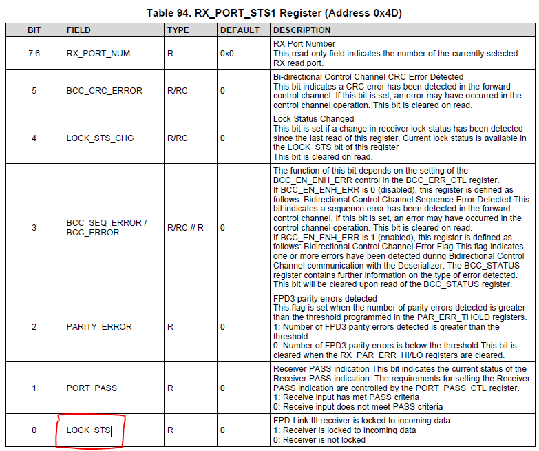

  • lock is needed for the serializer and deserializer to establish backchannel communication. There is a deserializer register to indicate lock status. You can find it in UB960 datasheet.
    If sensor/serializer comunication is working it means lock has been established. You can verify by reading sensor chip id register.
  • Hello, Mayank
    I have two questions.
    1. Is this the LOCK you said is correct?
    2. Can you tell me how to read I2C Register value from TDA4?
    I tried to find a way to read the register to check the register value I set, but I couldn't find it.
    Kim

  • Hello Mayank,
    It's a little different way, I checked the value after setting the register in U-boot.
    Register 0x4d LOCK status was active( it means register value is 1).
    Also, the register value of the serializer could be read through the Alias ​​ID.
    Currently, My Deserializer's register value is changed. a little.

  • Hello Brijesh,
    I use Fusion Application board rev.C.
    My sensor Output is YUV422. (UYVY)
    I think, It seems that the sensor settings are correct.
    My sensor spec,
    Image Sensor : ISX016
    Serializer : UB913
    Deserializer : UB960
    My Serdes config is
    Serializer
        {0x01, 0x30, 0x80},
        {0x03, 0xC5, 0x10},
        {0x0D, 0x55, 0x10},
        {0x05, 0x15, 0x10},
        {0x11, SERDES_I2C_SCL_HOLD_TIME, 0x10},
        {0x12, SERDES_I2C_SCL_HOLD_TIME, 0x10},
        {0xFFFF, 0x00, 0x0} //End of script
    Deserializer
        {0x4C, 0x01,0x10},
        {0x58, 0x58,0x10},
        {0xD5, 0xF0,0x10},
        {0x6D, 0x6F,0x10},
        {0x70, 0x1F,0x10},
        //{0x5B, (BSPUTILS_SER_ID_ADDR << 1U), 0x10},
        {0x5C, (SER_0_I2C_ALIAS << 1U), 0x10},   //E8(8bit)      => 74 (7bit)
        {0x5D, ISX016_I2C_ADDR<<1U, 0x10},       //34(8bit)     => 1A (7bit)
        {0x65, (SENSOR_0_I2C_ALIAS << 1U), 0x10},//80(8bit)     => 40 (7bit)
        {0x32, 0x01,0x0},
        {0x20, 0x00, 0x10},
        {0x21, 0x03, 0x0},
    And,
    I also said in the previous answer, LOCK_STS is set. (value is 1).
    I think, UB960 receiving valid data is 0x91(CSI0_FRAME_COUNT_LO)
    It was fixed at 0x01.
    Maybe it is fixed to 1 because it cannot deque?
    Thanks your answer, and any Advise.
    Kim
  • Hi Kim,
    FRAME_COUNT should keep incrementing. There is also LINE_SIZE register in UB960, can you check if LINE_SIZE is correct from UB960?
    Rgds,
    Brijesh
  • Hi Brijesh,
    I had some Deserializer changes.
    This is Deserializer value.
    0x91 (CSI0_FRAME_COUNT_LO) had a change. (01 -> 28)
    I think, the LINE_SIZE is 0x94 ( CSI0_LINE_COUNT_HI ) , 0x95 ( CSI0_LINE_COUNT_LO ).
    As you can see in the picture attached, Its value is 0.
    Is there any reason to be expected?
    Kim
  • Hi Kim,
    This means UB960 is not receiving data.. Could you please check your Ub960 configuration? Is the channel correct? and each channel correctly configured?
