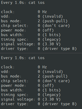

Our custom AM5728 board has MMC2 as an SD card slot. Unlike MMC0 / 1, the MMC2 has been unreliable. I noticed that even when the slot is empty, the output on /sys/kernel/debug/mmc2/ios  is acting erratically like in the attached GIF (top: MMC2, bottom: MMC0).
Can someone suggest what may be causing this?

  • Hi Mike, good to hear back from you.
    I will add logs I've been collecting, but here is what I see quite often:
    dmesg | grep mmc2
    [ 1.095182] mmc2: SDHCI controller on 480ad000.mmc [480ad000.mmc] using PIO
    Some minutes - hours later, my console gets flooded with these messages:
    [ 5914.099502] mmc2: Timeout waiting for hardware cmd interrupt.

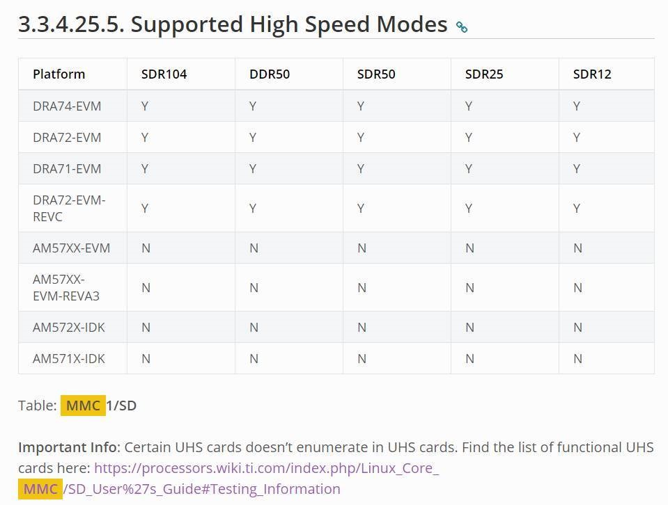

  • I stumbled upon the Wiki. Since we are basing off on the AM572X-IDK, I guess HS modes are not supposed to work. What's the difference between DRA7 platforms and AM57 platforms here?
  • Just an update - the UHS modes have been taken out due to limitation in the hardware design on AM57 series board [1].
    So my goal is to only get the default and HS modes working on MMC1 with 3v3.
    [1] https://github.com/torvalds/linux/commit/fb59ee37cfe20d10d19568899d1458a58361246c#diff-29dac349dd9c09e793b5c31b4af7f769
