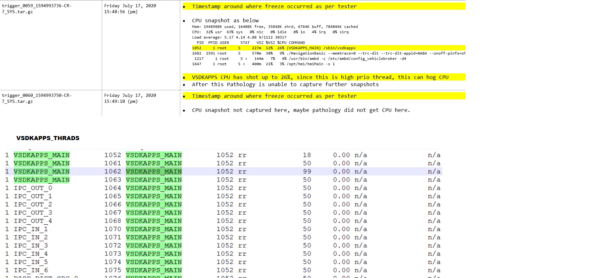

Hello TI Team,
UseCase: early_capture_lateweston_2s_2c_dsswb
Capture -> Display_Video
DispDistSrc_weston -> Display_m4
DispDistSrc_vid3 -> Display_vid3
Capture_dsswb -> Alg_SwCrc
- One of threads of apps.out is consuming high CPU. This scenario is observed when using Navigation.
-  Below we can see that VSDKAPPS_MAIN (apps.out) is occupying 26%  and after that system Freezes.
below are the various threads named in VSDKAPPS_MAIN:
Previous Tickethttps://e2e.ti.com/support/processors/f/791/t/883664
Raghu
  • Please find the missed attachments here and also IPU1 logs.

  • Column Headers:
    Iteration Count, Name of the thread, PID, Name of the process, PPID, Scheduling Policy, Priority ID, CPU load %, Ignore, Ignore
    Additional notes:
    1. Need TI to comment on whether this load of 26% is normal for this usecase. This scenario lead to overall system freeze.
    2. TI help how to modify the thread names and priority
    3. Review of priority of 99 for this thread
    4. How to debug this scenario further.
    Karthik

      Priority  TaskName
      PRI = 50, RemoteLog
      PRI = 99, ipcNotifyRecv
      PRI = 50, ipcMsgQTskMain
      PRI = 50, IPC_OUT_0
      PRI = 50, IPC_OUT_1
      PRI = 50, IPC_OUT_2
      PRI = 50, IPC_OUT_3
      PRI = 50, IPC_OUT_4
      PRI = 50, IPC_IN_0
      PRI = 50, IPC_IN_1
      PRI = 50, IPC_IN_2
      PRI = 50, IPC_IN_3
      PRI = 50, IPC_IN_4
      PRI = 50, IPC_IN_5
      PRI = 50, IPC_IN_6
      PRI = 50, NULL_0
      PRI = 50, NULL_1
      PRI = 50, NULL_SRC_0
      PRI = 50, DISP_DIST_SRC_0
      PRI = 50, DISP_DIST_SRC_1
      PRI = 50, DISP_DIST_SRC_2
      PRI = 50, DISP_DIST_SRC_3
      PRI = 50, ALGORITHM_0
      PRI = 50, ALGORITHM_1
      PRI = 50, ALGORITHM_2
      PRI = 50, ALGORITHM_3
      PRI = 50, ALGORITHM_4
      PRI = 50, ALGORITHM_5
      PRI = 50, ALGORITHM_6
      PRI = 50, ALGORITHM_7
      PRI = 50, DUP0
      PRI = 50, DUP1
      PRI = 50, DUP2
      PRI = 50, DUP3
      PRI = 50, DUP4
      PRI = 50, SYNC_0
      PRI = 50, SYNC_1
      PRI = 50, SYNC_2
      PRI = 50, SYNC_3
      PRI = 50, MERGE_0
      PRI = 50, MERGE_1
      PRI = 50, MERGE_2
      PRI = 50, MERGE_3
      PRI = 50, MERGE_4
      PRI = 50, SELECT_0
      PRI = 50, SELECT_1
      PRI = 50, GATE_0
      PRI = 50, GATE_1
      PRI = 50, GATE_2
      PRI = 50, GATE_3
      PRI = 50, SGXFRMCPY_0
      PRI = 50, NetworkCtrl
      PRI = 99, DataCollect
      PRI = 50, DispDistSrcLink_workLoop

    3) The macros are defined in the below file to set as a thread priority.
    vision_sdk/links_fw/src/hlos/system/system_priv_common.h
    vision_sdk/links_fw/src/hlos/osa/include/osa_thr.h
    The thread "ipcNotifyRecv" is having the priority of 99 & this having the highest priority because this thread used to receive the IPC message from the other core.
    Please find which thread is causing the issue & let me know the status.
    Gaviraju
