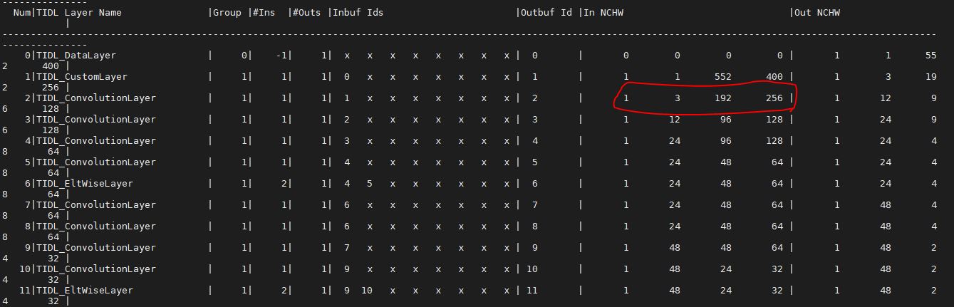

    The layer information shows as below:
    Num |TIDL Layer Name           |Group |#Ins |#Outs |Inbuf Ids          |Outbuf Id |In NCHW     |Out NCHW |
    2       |TIDL_ConvolutionLayer | 1         | 1    | 1       | 1 x x x x x x x | 2              |1 3 192 256 | 1 12 96 128 |

    The problem occurs on all layers after layer 2.
