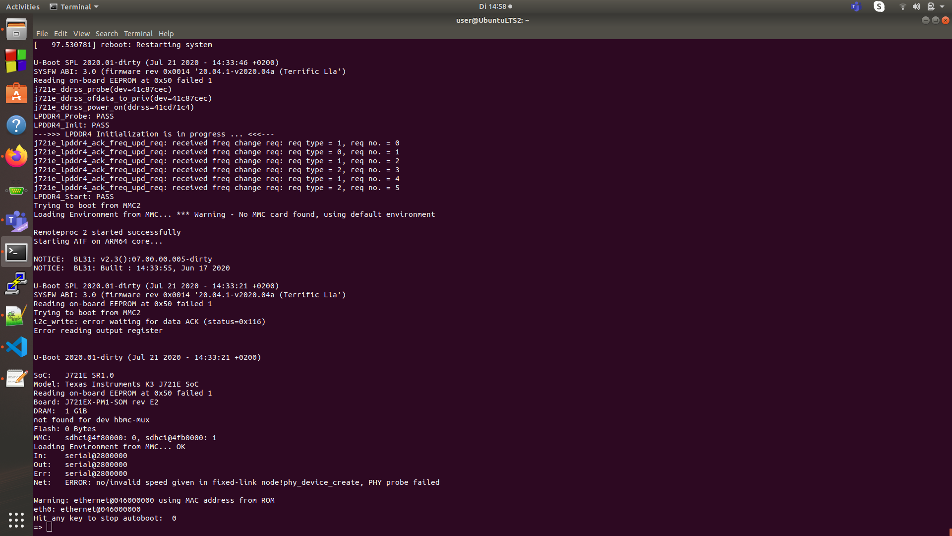

TDA4VM: Regarding Ethernet fixed-link speed Error
Part Number: TDA4VM
Dear TI,
I am able to run the SDK_07 on our custom board but now I am not able to run the Ethernet Switch configuration script and even GPIO toggle script. I am attaching the failure in this script and our patches that we run on the SDK for our custom board.
It worked completely fine with SDK_06.

 	cpsw-phy-sel@40f04040 {
 		compatible = "ti,am654-cpsw-phy-sel";
 		reg= <0x0 0x40f04040 0x0 0x4>;
-		reg-names = "gmii-sel";
+		reg-names = "gmii-sel";
+		fixed-link{
+		Speed = <1000>;
+		Full-duplex;

Error -->
LOG_DMESG -->
j7-evm login: root
Last login: Wed Jun 17 14:17:23 UTC 2020
root@j7-evm:~# cd /home/
root@j7-evm:/home# ls
Init_Device  bcm          gpio_toggle  root         spidev_test
root@j7-evm:/home# cd gpio_toggle/
root@j7-evm:/home/gpio_toggle# ls
GPIOToggle
root@j7-evm:/home/gpio_toggle# ./GPIOToggle
[  104.025576] export_store: invalid GPIO 133
./GPIOToggle: line 7: echo: write error: Invalid argument
[  104.029766] export_store: invalid GPIO 4
./GPIOToggle: line 10: echo: write error: Invalid argument
./GPIOToggle: line 13: /sys/class/gpio/gpio133/direction: No such file or directory
./GPIOToggle: line 14: /sys/class/gpio/gpio4/direction: No such file or directory
./GPIOToggle: line 20: /sys/class/gpio/gpio133/value: No such file or directory
./GPIOToggle: line 23: /sys/class/gpio/gpio4/value: No such file or directory
./GPIOToggle: line 28: /sys/class/gpio/gpio133/value: No such file or directory
./GPIOToggle: line 31: /sys/class/gpio/gpio4/value: No such file or directory
^Croot@j7-evm:/home/gpio_toggle# dmesg
root@j7-evm:/home/gpio_toggle# [  129.269382] Initializing XFRM netlink socket
[  132.737562] bridge: filtering via arp/ip/ip6tables is no longer available by default. Update your scripts to load br_netfilter if you need this.
[  132.755287] Bridge firewalling registered
    Regarding GPIO,
    It could be that the sysfs entries might have changed, follow the instructions from https://e2e.ti.com/support/processors/f/791/t/918654 to figure out correct sysfs entries.
    Vishal
  • Sysfs entries for GPIO has indeed changed from SDK 6.2 (Linux Kernel 4.19) to SDK 7.0 (Linux Kernel 5.4)

  • Regarding fixed-link, did you follow all the changes from previous bringup?
    https://e2e.ti.com/support/processors/f/791/p/883618/3276983#3276983
  • Hi Vishal,
    I see only 2 GPIOCHIP for main domain GPIO 1 & 2. We are using wkupdomain GPIO0_4 and main domain GPIO6 to blink the LED. In device tree i see pinconfig for both added.

    Also, the gpiochip 348 & 384 for me are shifted from yours by 48 but i don't think that is an issue.
    Manish
  • Hi Manish,
    I see wkup_gpio failure when trying SDK 7.0. Let me check on this and get back.
    [ 4.198196] davinci_gpio 42110000.gpio: IRQ index 4 not found
    [ 4.203968] davinci_gpio 42110000.gpio: IRQ not populated, err = -6
    You should be able to use main_gpio though. The gpiochip number is pretty arbitrary in kernel and there is no standard logic to it. Since TI EVM has some more GPIO expanders the numbers are different between TI EVM and ZF board.
    Vishal
  • Hi Vishal ,
    Yes the main Domain GPIO i can use and as you said wkup domain GPIO i am also not able to use.
    Manish
  • We are working on a fix for wkup_gpio0, will keep you posted.
  • Try the below changes for wkup_gpio to be functional
    1) Apply the attached patches to board-support/k3-image-gen-2020.04a folder
    https://e2e.ti.com/cfs-file/__key/communityserver-discussions-components-files/791/0001_2D00_soc_2D00_j721e_2D00_rm_2D00_cfg_2D00_Auto_2D00_generate_2D00_from_2D00_the_2D00_K3_2D00_Resource_2D00_Partitioning_2D00_tool.patch.patch
    https://e2e.ti.com/cfs-file/__key/communityserver-discussions-components-files/791/0002_2D00_soc_2D00_j721e_2D00_rm_2D00_cfg_2D00_Reassign_2D00_GPIO_2D00_interrupt_2D00_routers.patch.patch
    2) Build sysfw.itb from
    cd board-support/k3-image-gen-2020.04a
    make SOC=j721e
    3) Update sysfw.itb on the SD card boot partition
    Vishal
