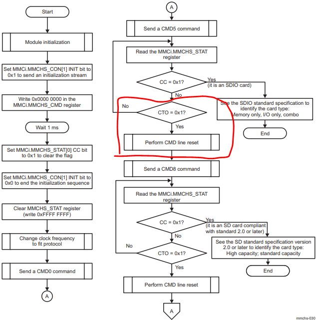

While testing the SD card, the following problem occurred.
Issue:
The SD card was removed and inserted during reading. SD card doesn't work.
It is the same as the Fixed Issues of PRSDK in the past.
(For example, PRSDK-4448 SD card insert/remove doesn't work in MMCSD)
Cutomers debug information
1. Start MMCSD_v1_read()
2. Vork mmcsd_check_transfer_ready(), CMD13:MMCSD_v1_transfer() ended for CTO.
3. When work CMD18 MMCSD_v1_transfer() , MMCSD_v1_cmdStatusFxn() run into infinite loop.
The latest SDK (6.3), MMCSD_v2, fixes it, but MMCSD_v1 does not.
Comparing TRM Figure 26-36 with MMCSD source code, they think that thereis no CMD reset when CTO occur.
Customers have following questions from this information:
Question 1:
How can they solve this issue? What should we do to "CMD line reset" ?
Question 2:
TRM Figure 26-40 "Perform DATA lines reset". What should we do?
Question 3:
Should we refer to MMCSD_v2 for the above abnormal cases?
Customers executed the following code after CTO, DEB, DCRC, DTO. They think it has improved.
Refer to MMCSD_v1_initSd() in MMCSD_v1.c
