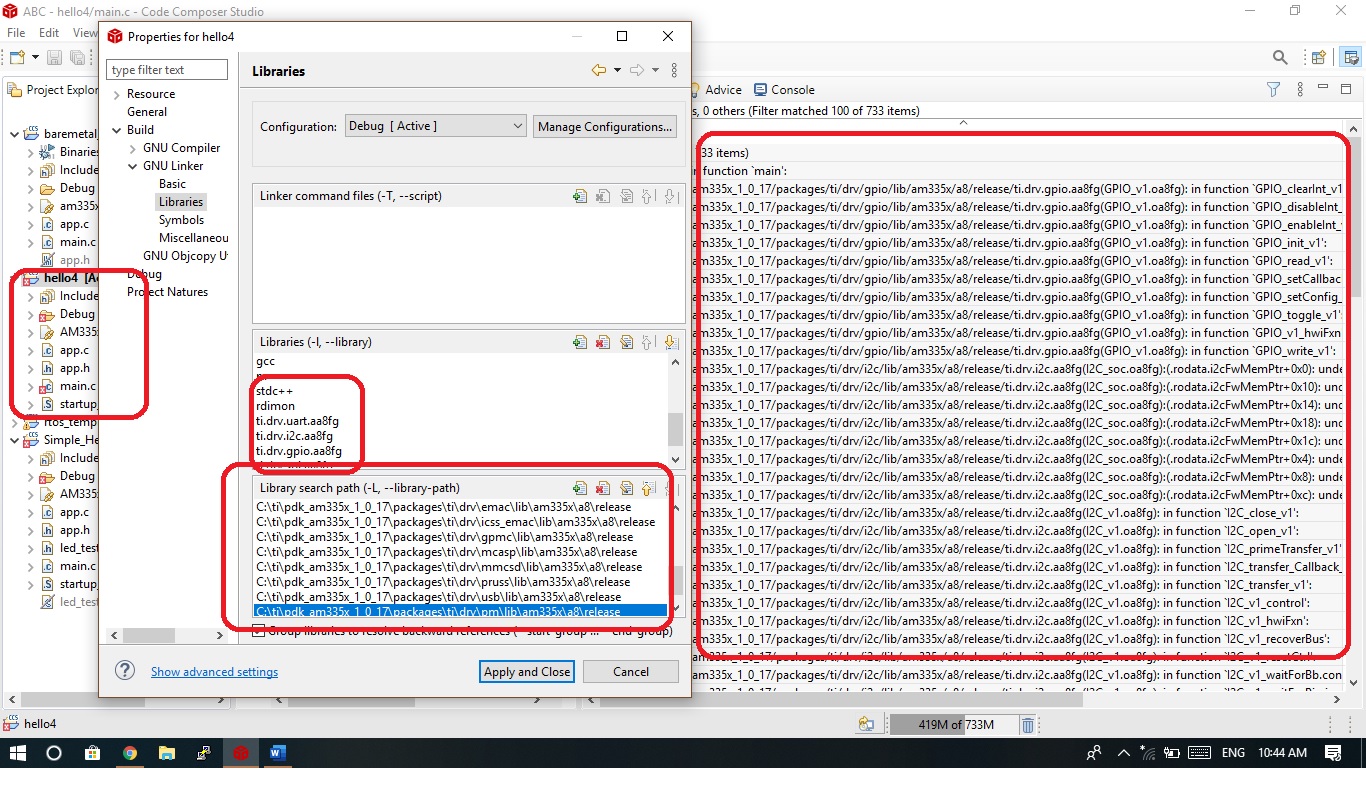

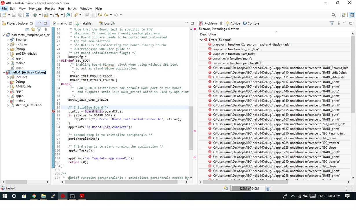

Here problem now is i added library into my new created project but i am unable to use the functions which i would like to use.
for ex: I created a new project and i have added "#include <ti/board/board.h>" library in to my new project and i am trying to use " status = Board_init(boardCfg);"  this function
but i am getting an error.
so i added predefined symbol as a evmAM335x also but still problem is not resolved.
Even i added full path like
/* Board header file */
#include <C:\ti\pdk_am335x_1_0_17\packages\ti\board\board.h>
Anyone knows how to resolve this.

  • Hi Anil,
    I think starting with the template app will ultimately save you time.
    For this issue, you may need to point the linker to your driver libraries.
    You can do that by going to the libraries tab under Properties -> Build -> Linker -> Libraries
    The libraries can then be found in <PDK_DIR>\packages\ti\drv\<DRIVER>\lib\am335x\a8\release
    Max

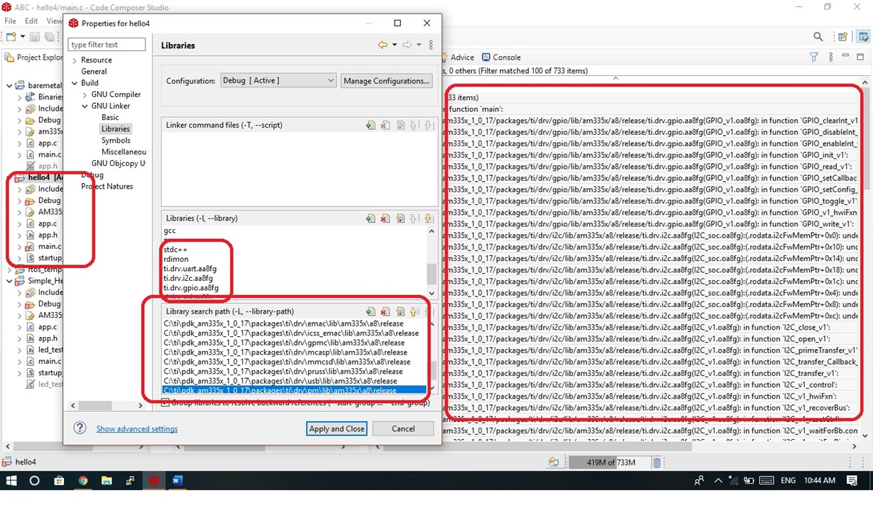

  • Hello Max,
    Don't we have any robust solution on this. Why we have to add so many libraries and so many things for this?
    even i added the library in the Library section i am getting an errors.
    You can see in the above image, how i added library as per your suggestion. But still i am facing problems and i am getting an errors.
    do we need to add all libraries like emac, gpio,gpmc,i2c,......usb?
     I have started understanding bare metal example with RTOS and without RTOS, most of the Part i understood.
    Anil D.
  • Hi Anil,
    You need to add libraries for the functions that you use in your program. For instance you've included: "Board, SPI, I2C, and mmcsd".
    You also will likely need to add "UART". Additionally, instead of Library search path, it might be better to link the actual .aa8fg files in the "Libraries" box above "Library Search Path"
    We encourage users to start with the template app or pdk driver examples, because they already have these libraries included.
    Max
