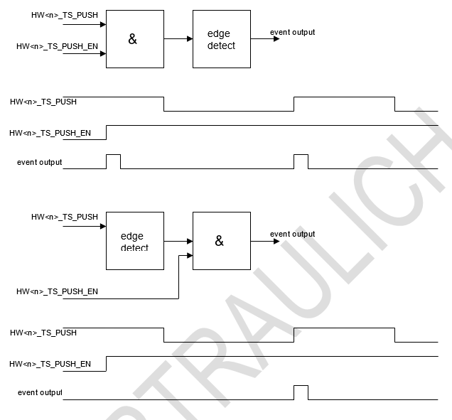

  • I'm trying to understand what options I have to make sure my HW TS push event is close to a previous PTM_CLK_UPDATED event.
    I believe that's the approach the TRM suggest, although I'm not sure how feasible that is:
    Software can enable the timestamp capture upon reception of the PTM Clock Updated interrupt.
    The PTM Clock Updated interrupt is asserted right after the EP has completed the PTM dialog with the
    RC and updated its local PTM timer. By using the interrupt to capture timestamps, software can ensure
    that the EP local time has been recently updated.
    What  happens when I set HW1_TS_PUSH_EN bit while the choosen PTM_LOCAL_CLOCK bit is already high? The TRM says that the HW push inputs are "Pulse" and need to stay asserted for at least 10 periods of the selected RCLK, but it doesn't contain a lot of details. Can I assume that "pulse" means "rising edge detection"? Is the edge detection already active while the *_TS_PUSH_EN bit is cleared, or is the hardware going to generate an event if I set the bit while the signal is already high?
    Dominic

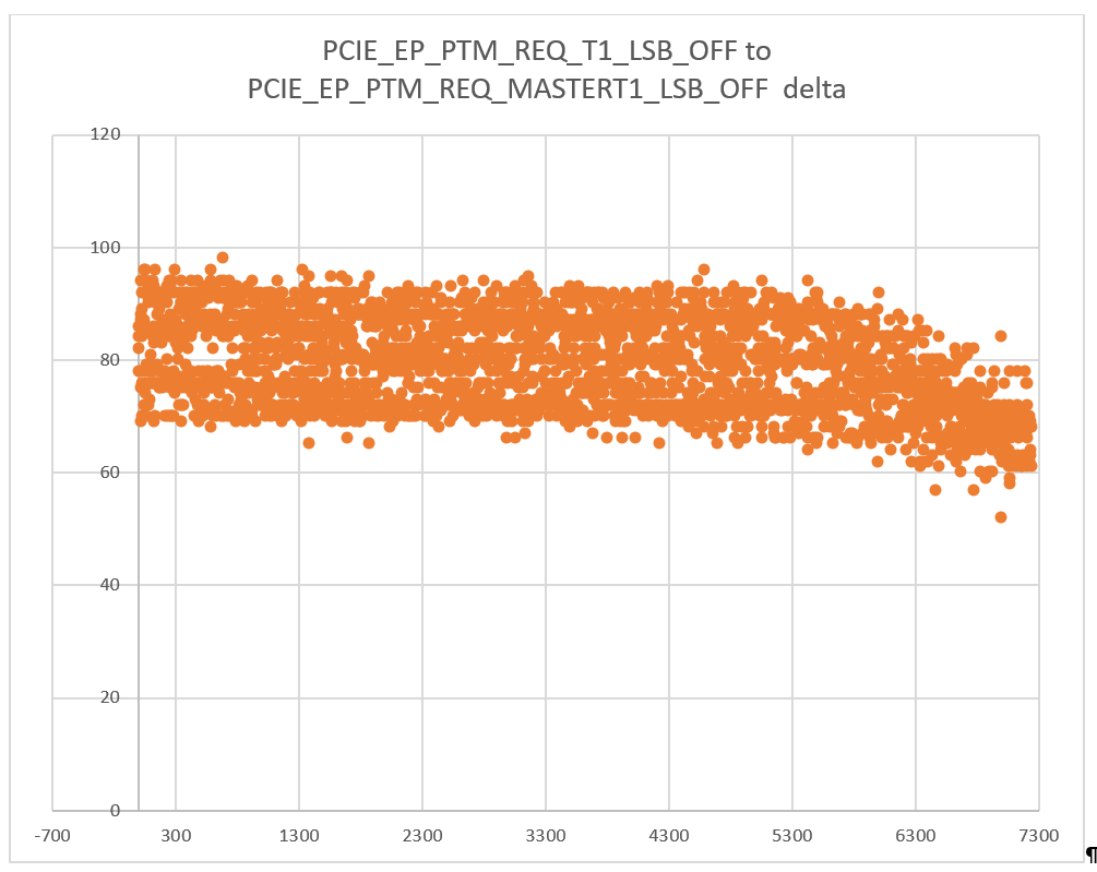

  • Hello Jian,
    thanks for your reply, but that didn't answer my questions.
    Yes, I understand that the PTM_LOCAL_CLOCK is a continuous, adjusted clock from the master clock. My question was HOW that clock is adjusted, and how it behaves BETWEEN the 10ms updates. My assumption is that if the local clock (which clock signal is the source for that 250 MHz bus?) runs faster than the RC, then the PTM_LOCAL_CLOCK will be stepped backwards after the 10ms update, if my local clock runs slower than the RC, then PTM_LOCAL_CLOCK will be stepped forward. During the 10ms period the two clocks are going to drift away from each other.
    I've plotted the differences between PCIE_EP_PTM_REQ_T1_LSB_OFF and PCIE_EP_PTM_REQ_MASTERT1_LSB_OFF for several thousand PTM updates. Towards the end I cooled down the x86 using freeze spray:
    Without additional cooling the local T1 timestamp was consistently ~80ns ahead of the master T1. After applying the freeze spray the difference dropped significantly. To me that means that the x86 frequency increased slightly, and that the frequency of PTM_LOCAL_CLOCK is not adjusted to match the RC, but only stepped on every update.

    • My experiments where I plotted T1 and T1-Master showed a pretty much constant difference, that was reduced by cooling down the x86. To me that indicates that the difference was determined by PPM drift, that got reduced because cooling down the x86 slightly increased it's rate.
    • I also saw an increased difference if I increased the PTM dialog interval. At the time I was looking at the PTM local clock in the EP config registers and at the RC's clock in the RC config registers separately, which is of course inaccurate, but the difference was pretty much linear with the increase of the PTM dialog interval.

  • Hello Jian,
    I've re-run my test with the increased PTM dialog interval. At the default PTM dialog interval of 10ms (PTM_REQ_LONG_TIMER=0x9) the difference between T1 and MASTERT1 is ~77ns. If I increase the PTM dialog interval to 100ms (PTM_REQ_LONG_TIMER=0x63), the difference between T1 and MASTERT1 is ~720ns. If I further increase the dialog interval to 200ms, the difference between T1 and MASTERT1 increases to ~1418ns.
    I'm looking at the following registers:
    PCIE_EP_PTM_REQ_T1_LSB/MSB_OFF: PTM Requester T1 Timestamp LSB/MSB
    PCIE_EP_PTM_REQ_MASTERT1_LSB/MSB_OFF: PTM Requester Master Time at T1 LSB
    To further verify this I've implemented a test that continously reads PCIE_EP_PTM_REQ_LOCAL_LSB/MSB_OFF and checks if the current value is greater or smaller than the previous value. Over a time of 10 seconds at a PTM dialog period of 256ms the PTM local clock was found to be stepped backwards 17 times. The test code read the PTM local clock ~20 million times, i.e. I'm sampling the PTM local clock every ~500ns.
    I'm pretty sure that the PTM requester local clock is NOT adjusted to match the master's frequency, but only stepped to the latest value determined by the PTM dialog.

    I believe the question is whether the HW<n>_TS_PUSH_EN bit is used to AND the HW<n>_TS_PUSH signal itself, or if it is used to AND the output of the edge detection logic:
    I understand that there's a race condition, i.e. if I look at the HW1_TS_PUSH signal BEFORE I set HW1_TS_PUSH_EN and find the signal low, and then look at the signal after setting the bit and find the signal high, then I wont know whether an event has been generated already, or if it is going to be generated on the next rising edge. But for all the other cases (low before and after, high before and after, high before and low after) I would know which edge triggered the event.
    Since you mentioned the "10 clocks" requirement from the TRM ("Each hardware time stamp input must be asserted for at least 10 periods of the selected RCLK clock."): Does that mean that the HW TS push has a fixed latency of 10 RCLK clocks? e.g. if I use a 100 MHz RCLK, is it guaranteed that the time stamp event is going to be generated at least 10 RCLK clocks after the rising edge of the HW<n>_TS_PUSH signal?
