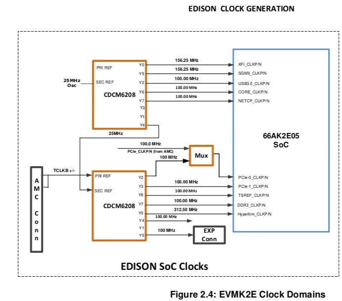

I am experimenting with the EVMK2EX board to create a PCIe Root Complex using PCIe-0 through the AMC. We confirmed that Pin 80 and pin 81 (FCLKA-/A+) are receiving 10 ns clock from an RDK switch, using a x1 lane SMA connection. The clock signals from SMA's pin 13/14 are connected to AMC's FCLKA+/FCLKA-.
My VxWorks driver is failing to establish PCIe link. There may be several reasons for the failure, so I wanted to first confirm the Clock signal propagation from the SoC to AMC.
Kindly let me know how the correct clock signal can be configured. The TRM and Schematics refer to BMC (TI LMS2D93), but other than TRM's Section 2.7 sentence that the LMS2D93 registers are accessible through SPI interface, I haven't found a reference to how the MUX can select AMC's FCLKA+/A-. Please point me to appropriate references.
Following diagrams are from the "EVMK2E Technical Reference Manual" spruin5.pdf
Figure 2.4 EVMK2E Clock Domains shows a Mux that controls which clock signal (from AMC / from CDCM6208) reaches SoC's PCIe-0_CLKP/N pair.
Based on eInfoChip's K2E_EVM_SCH_16_00175_03.pdf page 19, the IDT5V41068 PCI Clock Mux selects source of PCIE0CLKP_M/N_M pair.

    I am confused by your clocking questions.  Are you trying to use the K2E EVM as a PCIe Root Complex or a PCIe Endpoint.  Normally, an Endpoint receives a clock from a Root Complex or from an alternate source.  Why are you trying to supply a clock to a root complex?
    PCIe can operate with narrow band clocks or with SSC clocks.  When using SSC clocks, both the RC and the EP must receive the same clock.  If both are using narrow band clocks, then they do not need to be synchronized.  Are you using SSC or NB?
    Are you trying to work in single lane or dual lane mode?  You might want to limit your testing to single-lane until you have your clocking configuration resolved.
    Tom
  • @Rex, thanks a lot for the link and updates.
    @Tom, thanks for your reply.
    Pls see the Table 6-2 of 66ak2e05.pdf pins PCIE0CLKN/P, and PCIE1CLKN/P are Input only. Pls also see the Fig 2.4 from EVMK2E TRM captured in my original post. Given those two, I don't understand how K2E's PCIE0 "root complex can supply the clock" as normally expected.
    SSC vs NB clocks: We will be happy with NB at this point :-)
    Single lane only at this point.
    You're absolutely correct about focusing on minimal configuration until the clocking issue is resolved.
    and I am still reviewing code. Kindly post anything you come across.
  • Subodh,
    If you are operating with NB PCIe clocking, then the internal clock provided for the PCIe reference is sufficient.  You simply only need to make sure that the EP is also receiving a NB reference clock.  There is no need to supply an external clock to the EVM.
    Tom

  • Hello and ,
    As Tom wrote above "normally RC" is expected to supply PCIe Clock to downstream devices (switch / end point). However, EVMK2E board's Clock Source generates 3 clocks of 100 MHz - SATA_CLKN/P (terminates at PCIe-1 to SATA Controller bridge onboard), and PCIE0CLKP/N, and PCIE1CLKP/N. Both PCIExCLK terminate at K2E.
    Kindly confirm above following pages of schematics and please let me know if I am correct about that.
    Page 19: PCI CLOCK MUX and SOC Reference CLOCK
    Page 16: PCIe To SATA Controller
    Page 24: CLOCK SOURCE -2
    If my understanding is correct, then I have following questions for you:
    1. Is it possible - and if so how - for EVMK2E to provide clock to PCIe-0 Root Complex's downstream devices?
    2. If not, can an external clock be sufficient? Since it will be asynchronouse to the PCIe-0 data stream, will the Root complex work ok?
    3. With Intel's e1000e NIC card (example cited above) where was the clock source?
    4. In a different application, I want to use PCIe-0 as an End Point. Is it possible to use AMC FCLKA+/A- as PCIe-0 End Point's clock signals?
    Thank you very much.
  • Subodh,
    1.  This EVM is designed to either be a root complex where both devices use local, narrow band clocks or to be an end point where it either uses a local NB clock or it receives clock.  This EVM does not have standard support for providing a clock output.
    2.  Separate narrow band clocks that are asynchronous are acceptable.
    3.  I assume a NIC card is an endpoint that assumes that it will receive a clock from the root complex.
    4.  Yes, you can receive a clock over the AMC pins for operation as an endpoint.  Enumeration will be complicated since the device reset control is not connected over the AMC connector.  Also, most boot modes are too slow.  Developers normally have the endpoint code awake and waiting for the RC to start enumeration.
    Tom

  • Subodh,
    Is correct understanding that K2E PCIE port 0 is directly connected to a Broadcom device without any PCIE switch in between?
    And the K2E PCIE clock is supplied with the onboard 100MHz NB?
    How the Broadcom device PCIe is provided? Does it also have a onboard clock? Or it is supplied by the K2E through the AMC/SMA PCIe cable connection? Is your connection cable also passing through the PCIE clock? Note, you can't let Broadcom device to receive clock from both.
    >>>>Does the K2E PCIe0 interface needs to be initialized to accept asynchronous or synchronous mode for narrow band clock?>>>>Yes, but I think it is enabled and initialized on Linux driver, if you can see the training sequence on the scope, it should be fine.
    Regards, Eric
