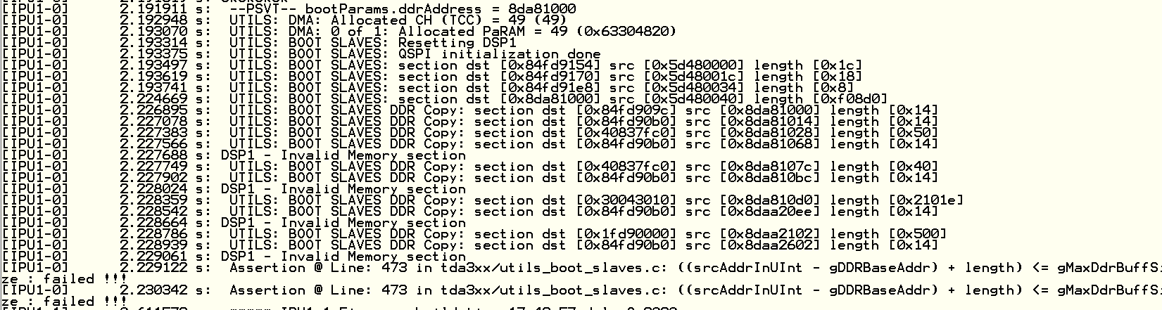

TDA3XEVM: Sometimes an error occurs when running the Utils_bootSlaves function
I refer to usecase fast_boot_iss_capture_isp_simcop_pd_display to enable DSP1.
In most cases, DSP1 is successfully enabled but sometimes an error message appears.
By the way, I did not make any changes to utils_boot_slaves.c. I use VisionSDK 03.04
The error message:
[IPU1-0] 2.658268 s: Assertion @ Line: 478 in tda3xx/utils_boot_slaves.c: ((srcAddrInUInt - gDDRBaseAddr) + length) <= gMaxDdrBuffSize : failed !!!
[IPU1-0] 2.658970 s: Assertion @ Line: 478 in tda3xx/utils_boot_slaves.c: ((srcAddrInUInt - gDDRBaseAddr) + length) <= gMaxDdrBuffSize : failed !!!
The boot slave code :

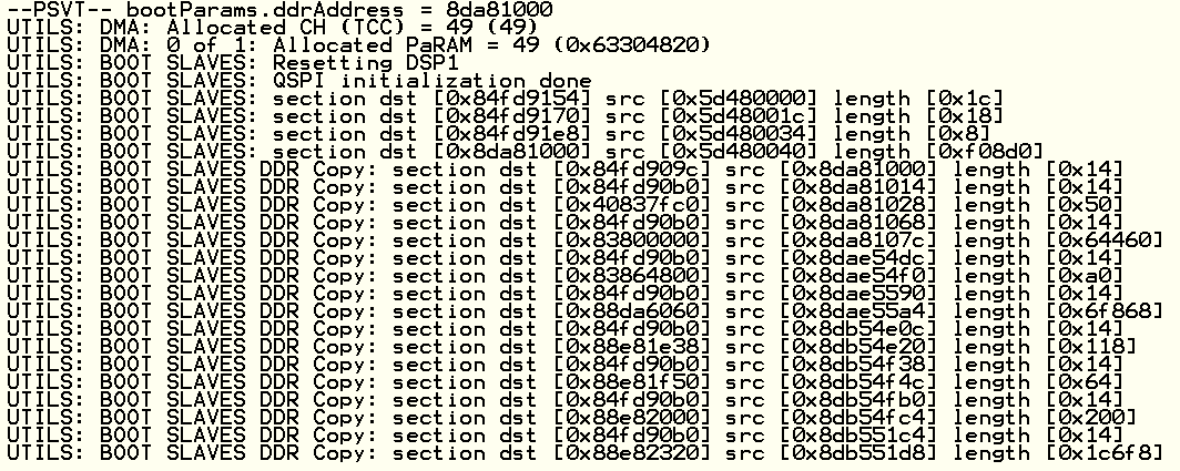

#ifdef FAST_BOOT_INCLUDE
    if (FALSE == done)
        poweOnToAlg = Utils_getCurGlobalTimeInMsec();
        /* boot & sync other cores here */
        ddrAddress =
            Utils_memAlloc(UTILS_HEAPID_DDR_CACHED_SR, MAX_UCLATE_IMAGE_SIZE, 4U);
        Utils_bootSlaves_paramsInit(&bootParams);
        bootParams.uclateOffset = QSPI_UCLATE_OFFSET;
        bootParams.ddrAddress = (UInt32)(ddrAddress);
        bootParams.useEdma = TRUE;
        bootParams.loadCode = TRUE;
        bootParams.maxDdrBuffSize = MAX_UCLATE_IMAGE_SIZE;
        bootParams.enableCrc = TRUE;
        Vps_printf(" --PSVT-- bootParams.ddrAddress = %x \n", bootParams.ddrAddress);
        Utils_bootSlaves(&bootParams);
        Utils_syncSlaves();
        Utils_memFree(UTILS_HEAPID_DDR_CACHED_SR, ddrAddress, MAX_UCLATE_IMAGE_SIZE);
