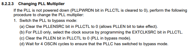

Dear all,
When I try to set PLL1 module to bypass mode, CCS debugger reports " target held in reset", and I can connect again only after power cycling board and restart CCS. Doesn't mean, how I change this mode, by code, or by register view in CCS, result is the same. I use OMAPL138 DSK (using DSP only). I've tried to do this after configuring PLL0, or before, or having PLL0 in bypass mode, result the same.
May it be cause I use cslr_pllc_C6748.h instead of cslr_pllc_OMAPL138.h?
Thanks in advance,
Dmitry
