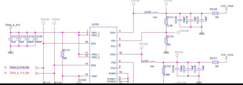

Hello, I am developing TDA4VM based on psdk_rtos_auto_j7_07_00_00_11. We use GPIO to enable the power supply of the camera module and deserializer.
The schematic circuit diagram is as follows, I need to configure the AE28 pin to GPIO OUTPUT mode,
I modified the application program based on the code of psdk_rtos_auto_j7_07_00_00_11/vision_apps/basic_demo/app_single_cam;

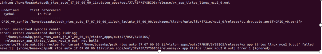

    but when
    make vision_apps
    There has error info.
Below are my questions
1. In the app_tirtos project, I did not call the gpio port, why this error occurred? Any suggestions to solve the problem?
2. In the demo routine, I did not configure any pin mode, so how are the functions of each pin configured after the board is started? Now I need to modify the pin configuration, how should I modify it?
3. In the vision_app project, how should I use fast configuration and use gpio port?
Kepei
  • Hello Kepei,
    For your first question, if you haven't already done so, please add the following lines to the file vision_apps/apps/basic_demos/app_tirtos/concerto_r5f_inc.mak in order for the application to link properly.
    LDIRS += $(PDK_PATH)/packages/ti/drv/gpio/lib/j721e/r5f/$(TARGET_BUILD)/
    ADDITIONAL_STATIC_LIBS += ti.drv.gpio.aer5f
    For the other questions, I will reach out to a colleague for the response.
    Lucas
  • Hi Lucas,
    Thanks for you reply, I had resolved the problem!
