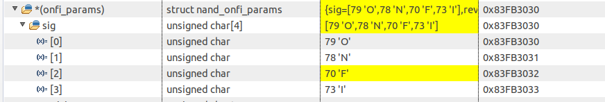

We are using a custom board based on the AM3352 processor with a Macronix MX30UF2G18AC 2G-bit NAND Flash Memory.
We received a board with a problem trying to boot, which stops in the SPL bootloader.
We were using the Blackhawk USB560v2 STM Emulator to load to SPL and U-Boot binaries directly into RAM using the JTAG using the CCS 8.3.1.
Analyzing the issue, we find out that we are having problems when trying to read the ONFI Parameter Page Read. There is a CRC error when calculating the message received. We discovered the problem when we received the field Parameter Page Signature. We should had received the string "ONFI" but instead we received "ONGI" in the first read:
then the CRC error occurs. But in the second read we received the "ONFI" string:
And then the U-Boot console appears.
Using the document Open Nand Flash Interface Specification, page 94, we find out that this is a field that never changes (like a static header):
We don't know if this is a problem with the flash memory device, something related to the gpmc configurations or to some "noisy" in the communication channel...
Actually we have approximately 20,000 boards in field and we are worried that this problems could occur in more boards. We can send the schematics and also any more information about the code that could help.
Could you please send any suggestions that could help us understand what's going on?

    In a normal operation, the NAND device is used to boot the board and to load the binaries (SPL, U-Boot, Kernel, rootfs), but in this scenario when we use the SPL image that is loaded from the NAND than we got the error:
    U-Boot SPL 1 - 2013.01.01.UCC3.R18 (Apr 28 2020 - 14:55:29)
    ERROR! NAND - CRC mismatch! Expected 0x5b16, got 0x65e9
    ### ERROR ### Please RESET the board ###
    This way, we were thinking that maybe the SPL image in the FLASH was corrupted then we pluged our JTAG trace and we loaded the SPL and U-Boot images directly into the RAM, but we still got the same problem without using the NAND device to load the binaries.

    1. Did you modify SPL/u-boot nand driver code to work around the original reported NDND ID read issue?
    2. Were you be able to boot SPL from the same NAND device consistently every time?
    If your answer is yes for Q2, SPL copy from NAND to on-chip SRAM by on-chip rom code works as expected. This would give us some reference points to configure GPMC timings to match the NAND device timing specifications.
    -Hong
  • Hi Hong,
    Thanks for your reply.
    1. Yes, I have modified the SPL/U-Boot code in the nand driver code. Earlier, we were reading the nand ONFI Page Parameter just once. We weren't trying to read it in a second, or a third time. Now I have modified it to try to read at least three times and after this it could fail. Because our problem only occurs in the first read, now the SPL/U-Boot seems OK.
    2. Well, when I was using that version of SPL/U-Boot that only reads one time the ONFI Page Parameter then the boot always failed. Now that I've modified the SPL/U-Boot code, I sent the binaries from the SPL/U-Boot using the JTAG to the RAM memory, and then using the U-Boot console, I wrote the SPL/U-Boot binaries to the nand flash. So my answer is yes, because now I can boot the board consistently every time (using the nand flash) and I can also load the Kernel, but I got those messages that I showed and the panic.

  • Hi Leonardo,
    From your descriptions,
    1. SPL copy from NAND to on-chip SRAM by on-chip rom code works every time => NAND device itself would be good.
    Please note that NAND device detection mechanism in rom code is described below in TRM 26.1.8.4.2 Initialization and Detection:
    The ONFI Read ID (command 90h /address 20h) is sent to the NAND device. If it replies with the ONFI signature (4 bytes) then a Read parameters page (command ECh) is sent. If the parameters page does not have the ONFI signature, then the ONFI identification fails. If the ONFI Read ID command fails (it will be the case with any device not supporting ONFI) then the device is reset again with polling for device to be ready (with 200ms timeout). Then, the standard Read ID (command 90h / address 00h) is sent. If the Device ID (2nd byte of the ID byte stream) is recognized as being a supported device then the device parameters are extracted from an internal ROM Code table.
    2. u-boot copy from NAND to DDR by SPL looks good with the workaround (adding 2nd ONFI ID signature read).
    Is the kernel copied from NAND to DDR by u-boot before kernel booting?
    -Hong
  • Hi Hong,
    Thanks again for your reply.
    Yes, the kernel was copied from NAND to DDR by u-boot using the console.
    Analyzing the 26.1.8.4.2 Initialization and Detection, I would ask, do you think that maybe the NAND device is working properly ?
    Leonardo Amorim
  • Hi Leonardo,
    The on-board NAND device itself looks good based on testing run so far:
    1/. SPL copy from NAND to on-chip SRAM by rom code
    2/. u-boot copy from NAND to DDR by SPL (w/ the workaround)
    3/. kernel copy from NAND to DDR by u-boot
    From your kernel log, it shows NAND device parameters were read by kernel driver.
    [2020-07-30 11:38:49.212] [    0.867613] nand: Could not find valid ONFI parameter page; aborting
    [2020-07-30 11:38:49.219] [    0.875119] nand: device found, Manufacturer ID: 0xc2, Chip ID: 0xaa
    [2020-07-30 11:38:49.225] [    0.881885] nand: Macronix NAND 256MiB 1,8V 8-bit
    [2020-07-30 11:38:49.234] [    0.886864] nand: 256 MiB, SLC, erase size: 128 KiB, page size: 2048, OOB size: 64
    The kernel panic in your log seems caused by rootfs.
    [2020-07-30 11:38:49.359] [    1.012864] Kernel panic - not syncing: VFS: Unable to mount root fs on unknown-block(0,0)
    -Hong
  • Hi Hong,
    After you said that nand flash appears to be working fine, I erased the kernel and rootfs binaries that was in the flash memory and I loaded the flash with another binaries of kernel and rootfs, and surprinsingly the kernel panic is not occuring anymore. Now I can login into the buildroot correctly.
    I believe that this kernel panic was not caused by the onfi page read error but by a a known failure in the rootfs remote update that we already know. In this case, the rootfs image was corrupted. We have another boards that are facing the same issue right now.
    Then I could say that we faced two problems at the same time: The first one is this with the onfi parameter page read and the second, which is not related with the flash, a corrupted rootfs image.
    What still seems strange to me is that we first read the Parameter Page Signature with a error and then we read that correctly. What could be the cause of this strange behavior in the nand flash? And should we be concerned about this error ?
    Leonardo Amorim
  • Hi Leonardo,
    It is good to know that NAND booting works for you now.
    Regarding stranger behavior of ONFI parameter table signature reading, have you checked with NAND vendor?
    From ONFI spec www.onfi.org/.../onfi_2_0_gold.pdf
    5.5. Read ID Definition
    When issuing Read ID in the source synchronous data interface, each data byte is received
    twice. The host shall only latch one copy of each data byte. See section 4.3.2.4.
    It seems to me that ONFI page signature is read correctly by rom code when loading SPL from NAND.
    -Hong
  • Hi Hong,
    After out team had discussed here, we decided that is highly problably that our SPL/U-Boot and Kernel codes are working fine and we think that the NAND device is working fine also, but we don't know yet about this behavior.
    We haven't checked yet with the NAND vendor about this, but we'll do this soon. For now, the information you gave us is enough to close this topic.
    Thank you once again for your informations!
