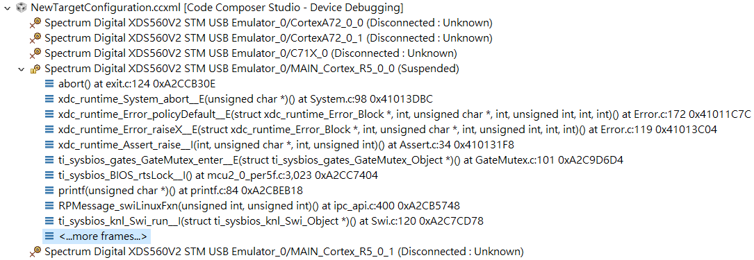

    There is logs on main_uart2 now, and it says
    Assertion @ Line: 97 in V1/cpsw_appboardutils_j721e_evm.c: BOARD_SOK == boardStatus : failed !!!
    Is this caused by the absence of daughter board?
    If it is, how do I bypass the board detection and phy setting? (The connection between TDA4 and the switch is MAC-to-MAC.)

  • Hi Eric Chen,
    The line that is crashing is trying to do a GPIO operation via I2C GPIO expander that is present on TI EVM common processor board. This does not apply to custom hardware, so please try commenting this line.
    Vishal

  • Hi Vishal,
    It looks like it stuck at "Wait for Linux VDev ready".
    void rpmsg_vdevMonitorFxn(UArg arg0, UArg arg1)
        int32_t status;
        /* Wait for Linux VDev ready... */
        while(!Ipc_isRemoteReady(IPC_MPU1_0))
            Task_sleep(10);

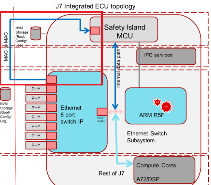

    Here are some questions:
        1. Why does the Ipc_isRemoteReady() function check the core and return false when the core is A72?
            Shouldn't remote core be A72 and run Linux?
        2. If we only use CPSW_MAC_PORT_1 for SGMII, can we disable every other ports?
            Since we look at the block diagram of integrated switch, there is a MAC-to-MAC port connected to MCU.
            Is it CPSW_MAC_PORT_0?
            If it is, should it always be enabled?
        3. We tried to enable CPSW_MAC_PORT_0, but EthFw fails at CpswMacPort_matchesEnetCtrl().
            We set it to RGMII mode (default), but the status read out by CpswSoc_getEnetControl() is SGMII.
            What could be the problem?

  • Hi Eric,
    -1-
    In case of A72 This API checks if Linux has marked the device as ready.
    Were there any changes made to cpsw9g_virt_mac node of dts?
    Could you share the full Kernel log also?
    -2-
    Yes, other ports can be disabled.
    There is no MAC to MAC connection to MCU by default. MAC_PORT_0 on EVM is connected to a RGMII PHY.
    -3-
    This mismatch means there is some mismatch in port configuration between Board_ethConfigCpsw9g() and CpswAppBoardUtils_setPhyConfig()
    Vishal

    After kernel loaded the  j7-main-r5f0_0-fw successfully, the ethfw pass the "Wait for Linux VDev ready" and later crashed at appRemoteDeviceLateAnnounce(IPC_MPU1_0).
    Eric Chen
    Can you rename the app_remoteswitchcfg_server.xer5f file to j7-main-r5f0_0-fw and place it in /lib/firmware and test?
    Vishal
  • Hi Vishal,
    I just tried it, the ethfw crashed at the same place.

    On TDA4EVM, there are app_remoteswitchcfg_server.xer5f and j7-main-r5f0_0-fw (vision app) under /lib/firmware/, and ethfw works fine.
    Is there any adjustment need to be done?

    Could you connect CCS and get the call stack of crash?
    Vishal
  • Hi Vishal,
    If I load firmware on main_r5f0_0 in kernel, I cannot load program on main_r5f0_0 in CCS.
    But, if I do not load firmware on main_r5f0_0 in kernel, EthFw will stuck at isRemoteReady() loop.
    In this case, all I can see in CCS is the log in the function isRemoteReady().
    In addition, we observed that there is "virtio_rpmsg_bus virtio3: creating channel rpmsg-kdrv addr 0x1a" in kernel log.
    Does this mean the function RPMessage_announce() actually announce the message successfully?
    Btw, the crash of EthFw always happens right before the linux login (arago project logo) shows up.
    Eric Chen
  • Hi Eric,
    When kernel loads firmware, are you able to attach to main_r5f0_0?
    If you can attach, can you just load symbols and not do load program?
    Vishal
  • Hi Vishal,
    When kernel loads firmware, I can connect to main_r5f0_0 and load symbols as below.
    Eric Chen
  • Hi Vishal,
    Sorry, the crash is caused by a printf() that I misused in function RPMessage_swiLinuxFxn() in very early stage.
