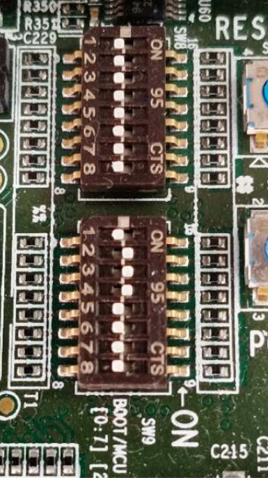

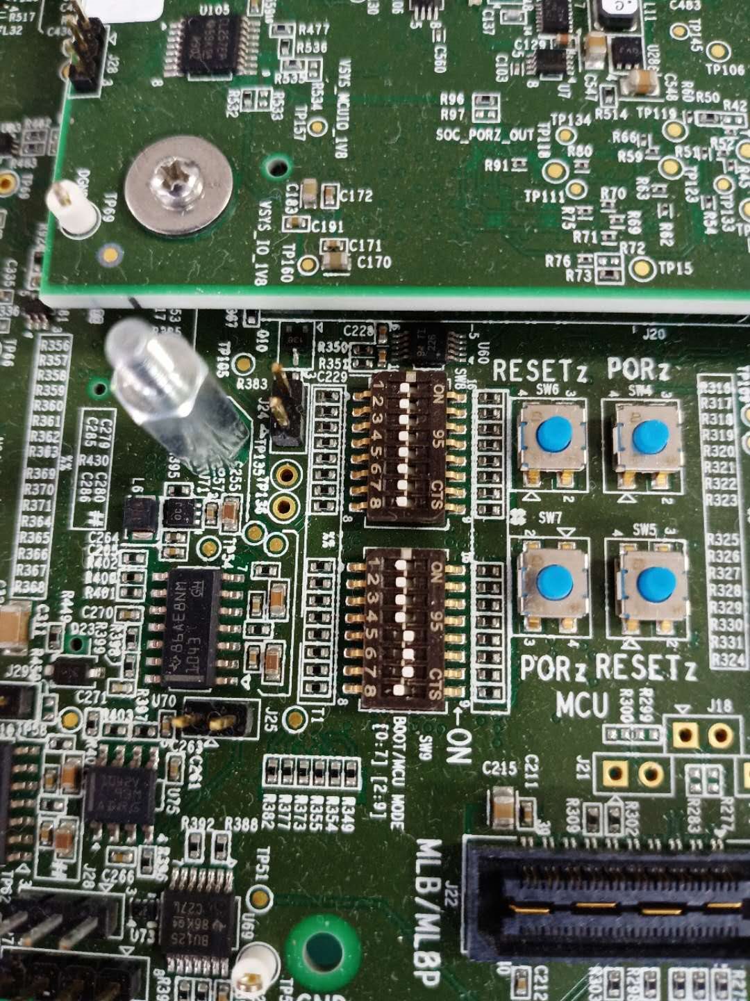

I reference the 4.1.1.10.4.2. OSPI Boot of psdk_rtos_auto_j7_06_02_00_21/gateway-demos/docs/Can-Eth-User_Guide.html to flash OSPI image. The flash_programmer can flash successfully. But other image always report Transmit of header Failed! What 's wrong of my step ?

lyp@lyp-Desktop:~/hd3/ti/uniflash_6.1.0$ sudo ./dslite.sh --mode processors -c /dev/ttyUSB1 -f ~/tda4/mcusw/tiboot3.bin -d 3 -o 0
Executing the following command:
> ./ProcessorSDKSerialFlash -c /dev/ttyUSB1 -f /home/lyp/tda4/mcusw/tiboot3.bin -d 3 -o 0
For more details and examples, please refer to the UniFlash Quick Start guide.
ProcessorSDKSerialFlash CLI Tool
Copyright (C) 2017-2020 Texas Instruments Incorporated - http://www.ti.com/
Version 1.3.0.0
Transferring the Image to Flash Programmer..
Opening Port Successful!
File Transfer Failed!
lyp@lyp-Desktop:~/hd3/ti/uniflash_6.1.0$ sudo ./dslite.sh --mode processors -c /dev/ttyUSB1 -f ~/tda4/mcusw/sysfw.bin -d 3 -o 40000
> ./ProcessorSDKSerialFlash -c /dev/ttyUSB1 -f /home/lyp/tda4/mcusw/sysfw.bin -d 3 -o 40000
Version 1.3.0.0
lyp@lyp-Desktop:~/hd3/ti/uniflash_6.1.0$ sudo ./dslite.sh --mode processors -c /dev/ttyUSB1 -f ~/tda4/mcusw/app -d 3 -o A0000
> ./ProcessorSDKSerialFlash -c /dev/ttyUSB1 -f /home/lyp/tda4/mcusw/app -d 3 -o A0000
Version 1.3.0.0
