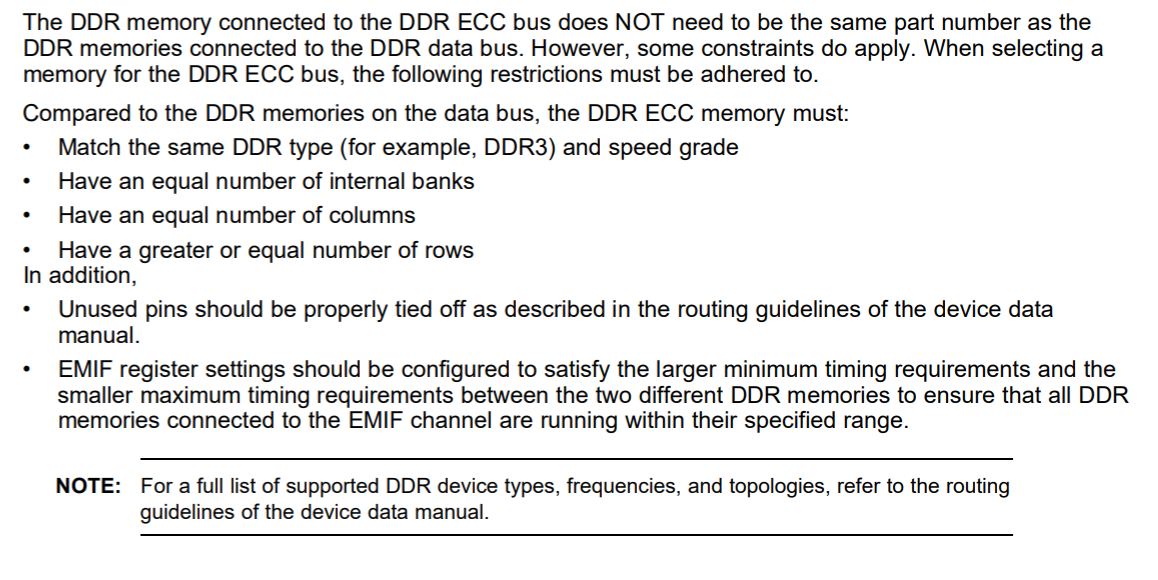

I'd like to check the verified DDR of TDA3MVSBFABFQ1 for automotive DMS application. Could you recommend the verified DDR for TDA3MVSBFABFQ1? Please share it with me if you have the verified DDR list.

TI does not provide such a list. The TDA3MV device supports JEDEC compliant LPDDR2, DDR2 and DDR3 devices that adhere to the datasheet DDR layout guidelines:
