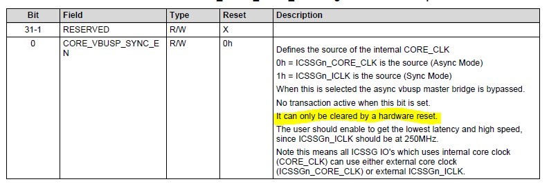

    So my suspiction is that either SBL or SYSFW manipulates the register ICSSG_CORE_SYNC_REG of ICSSG2.
    A TI collegue gave me the hint that when bit CORE_VBUSP_SYNC_EN has been set and then afterwards cleared, we read it as 0, but the behavior could be like set to 1, because clearing this bit is only valid by a hardware reset:
    My problem is now that I cannot find any location where this register is written in SBL (or in SYSFW?).
