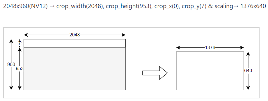

Hi.
I used MSC for scaling such as below.
The result is not NV12 but NV21.
Can you check this issue?
I'm attaching coeff , scaling ratio, the source file and result file.

[input file (2048x1280)]
0000000001_2048x1280_input.zip
[output file (640x256)]
0000000001_640x256_lfr.zip
