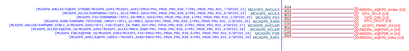

    in our custom board we have access  pru GPI/GPO
    now i am thinking using bit-banging implement spi for External ADC interface
