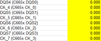

Dear Champs,
My customer developed custom board using TMS320C6655 as below and want to know how they input the lengths of DQS and clock in the DDR3 PHY calc excel sheet(
http://www.ti.com/lit/zip/sprabl2
In this case, they should input below values into excel sheet?(DQSx = 1.13, CK0/1 = 1.5, CK2/3 = (1.5 + 0.5) = 2.0
And, how DQS4~7 should be input? should it be '0'?
